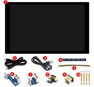

- Waveshare 10" HDMI Touchscreen
https://thepihut.com/products/10-1inch-capacitive-touch-display

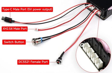

- Waveshare UPS Module 3S
https://thepihut.com/products/ups-module-3s

The screen comes with some small brass standoffs, secure these to the screen and mount the Pi so that the USB and HDMI connectors line up and can be inserted. Use 2x M2.5 screws and the ends of the hat standoffs to secure the Pi to the back of the screen.

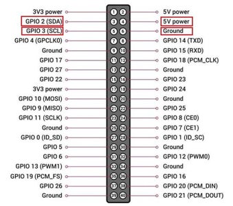

We need 4 Dupont female to female wires to connect 5V, Ground, SDA, SCL these go to PI Pins, 3,4,5,6 (connect later) - THE PICTURE SHOWS THE PINS FROM THE UNDERSIDE.

Connect the 4 Dupont wires as per the diagram to the PIs GPIO header pins (remember - the pins are shown from the underside!)

The key switch and power input connectors need to be extended so, since we are not using the original power button, cut and strip the wires from the button, extract the metal pin connectors from inside the JST connector and solder these together, cover with shrink tubing. Do the same for the key switch, using the spare JST connector that comes with the UPS Module.
Solder 4x female dupont wires to the momentary LED power button.

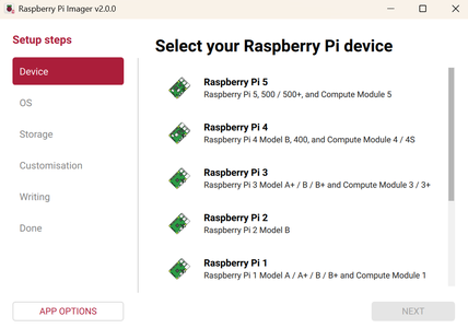

There are plenty of resources to help with installing an OS on the Pi. I have stuck with the standard Pi OS for now. Use Raspberry Pi Imager to download and install the OS. https://www.raspberrypi.com/software/
The screen should be recognized by the Pi without any configuration, but if you need any help or adjustment refer to the wiki here: https://www.waveshare.com/wiki/10.1DP-CAPLCD
