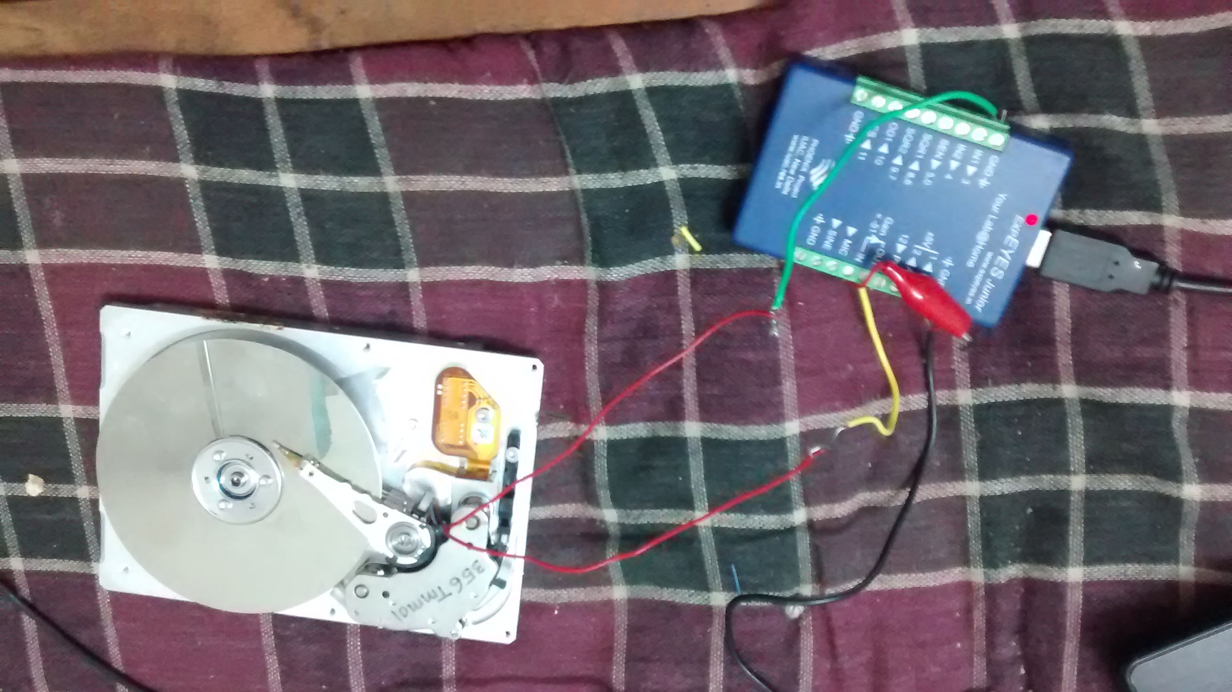

Step 6: Now for Some Hacking.
Solder a piece of long wire on to the terminals shown in the picture. (sorry about the blurry picture) This is the wire to be connected to the amplifier.
Note: The thinner the wires are, the better, because then the read/write head will have enough room to move freely.
Step 7: Spindle Motor Hack.
Connect another piece of long wire to the spindle motor terminals (at the bottom of the HD)
This step isn't necessary but adds to it.
Step 8: Reassemble the HD.
Now put all parts together except the head lock and the top cover and Don't forget to screw the read/write head back on.
Step 9: Completed.
The mod is complete. Connect the wires to your amp. Mine is 30w x 2 so that i can connect the spindle motor and the read/write head seperate and each of them gets 30w = 60w total.

Reply 6 years ago
There are 2 magnets (at bottom and at the top of the head), and there is a coil (winding) at the end of the head; so when you give the coil some sound it starts to move because of the magnets
