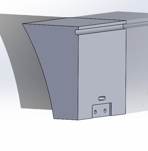

Step 3: Solidworks
design brackets in Solidworks to fit your hard hat
Step 4: 3D Print
Save Parts as STL files and 3D print two of both parts

2x
- Use 4 screws to connect your speakers to out portion of bracket
- connect both parts of brackets with the hinges and screw that come with it.
- thread speakers wires through from the first bracket through the hard hat.
- tape the inner bracket to the hard hat with strong and durable tape.
