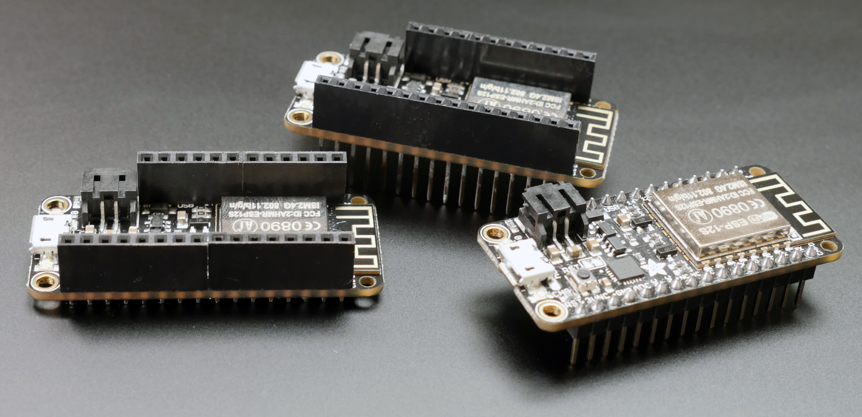

You have a few options when it comes to connecting to your Feather Huzzah board. The connectors we'll attach are called header pins (or just "headers" for short), and they are available in several flavors.
You can purchase the Feather Huzzah and other ESP8266 boards preassembled with male or stacking headers, but if you want terminal blocks or some other way to connect, you'll have to solder them up yourself.

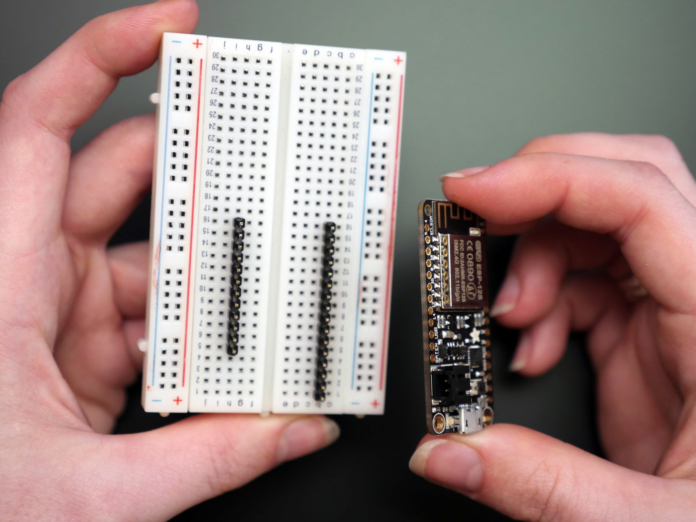

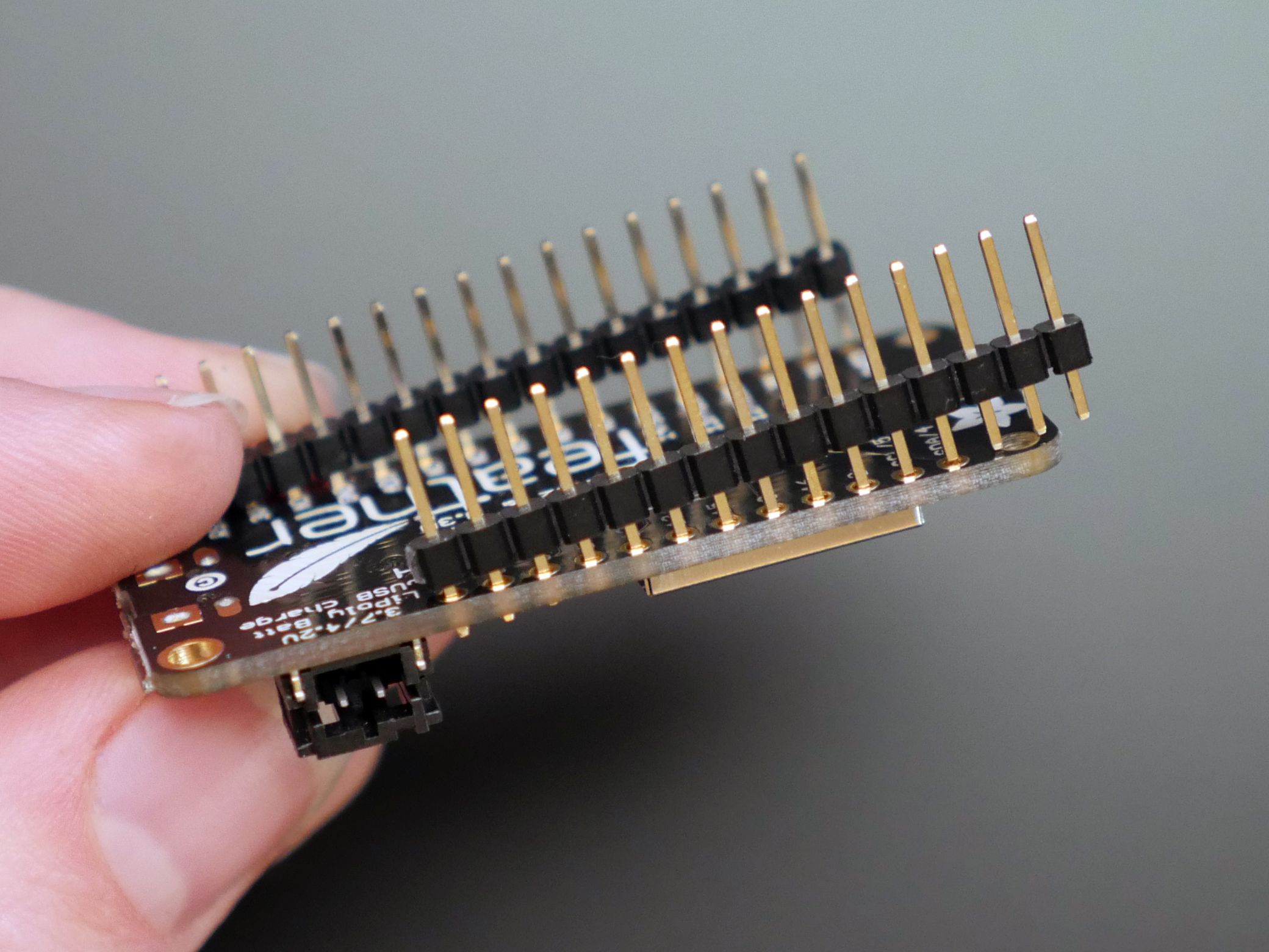

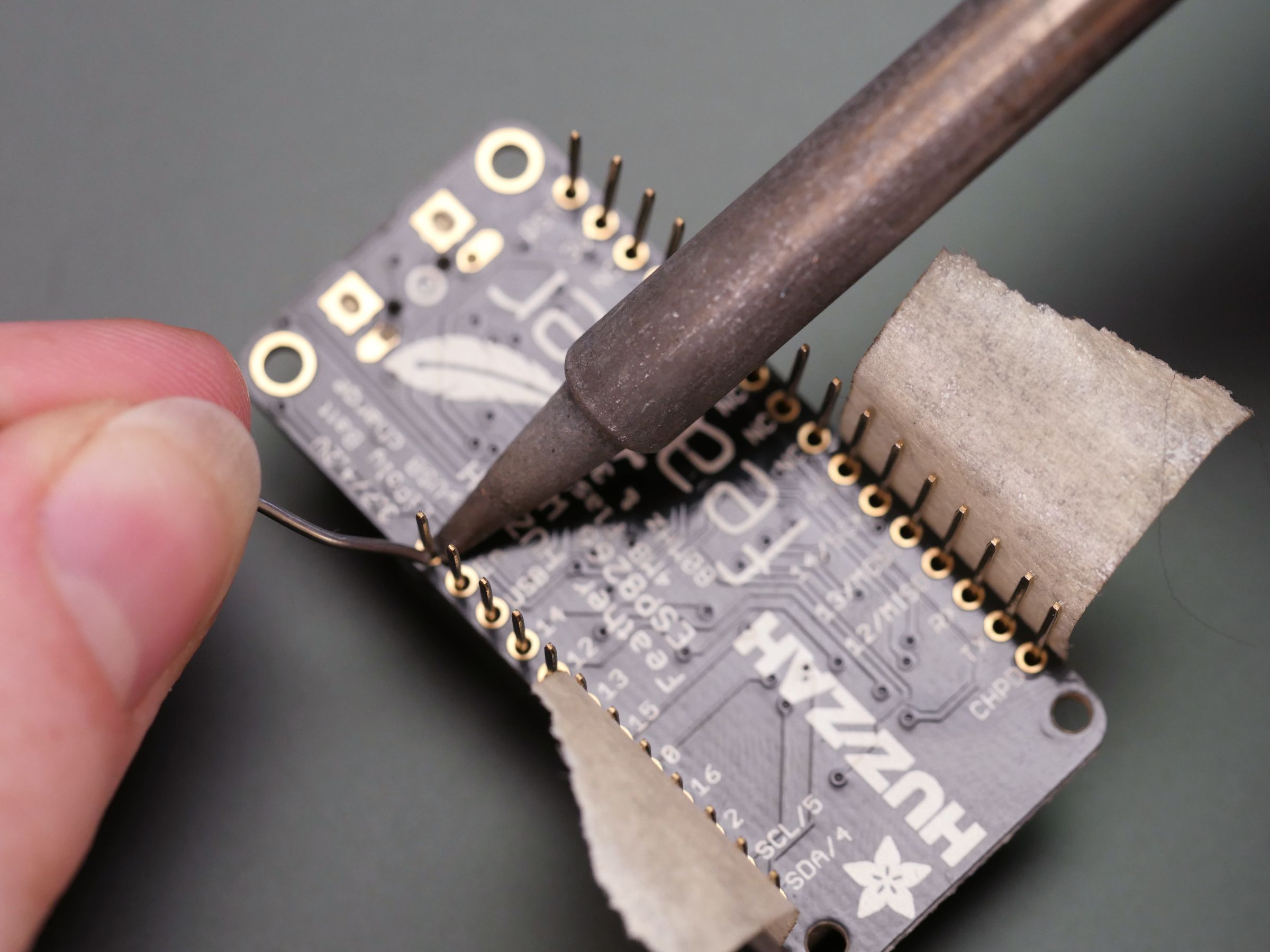

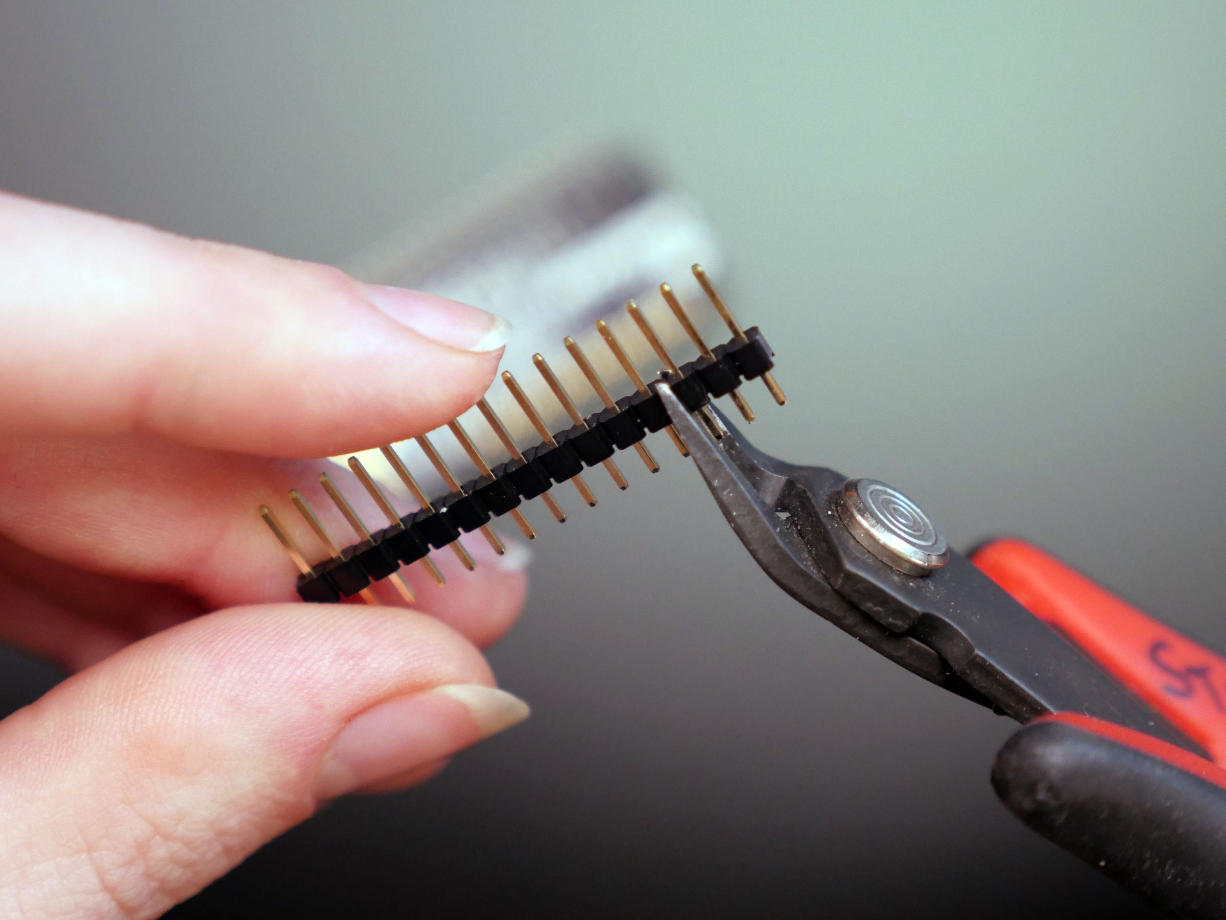

To solder on plain male header pins, first use the board to measure and cut the strips to length, if necessary.

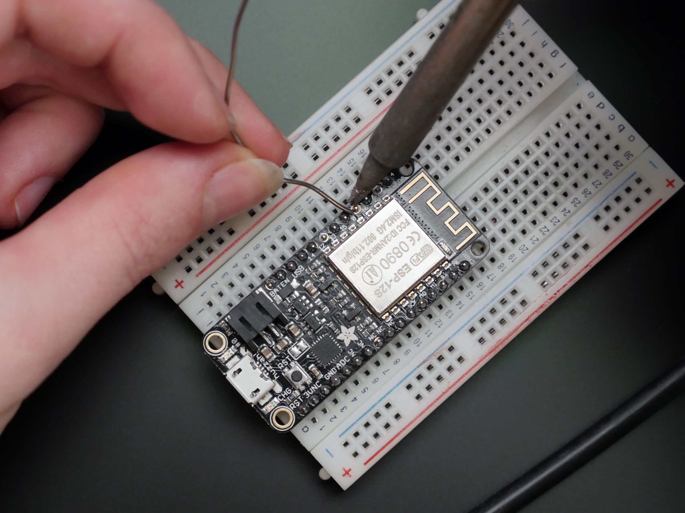

Insert the short end of the pins into the underside of the board and sandwich them into a solderless breadboard to align the pins and clamp them in place while soldering. Solder one pin on each strip to stabilize any wobble, then go back and solder the rest of the pins in place. This same header soldering procedure is handy for lots of other boards and accessories— add it to your toolbox!

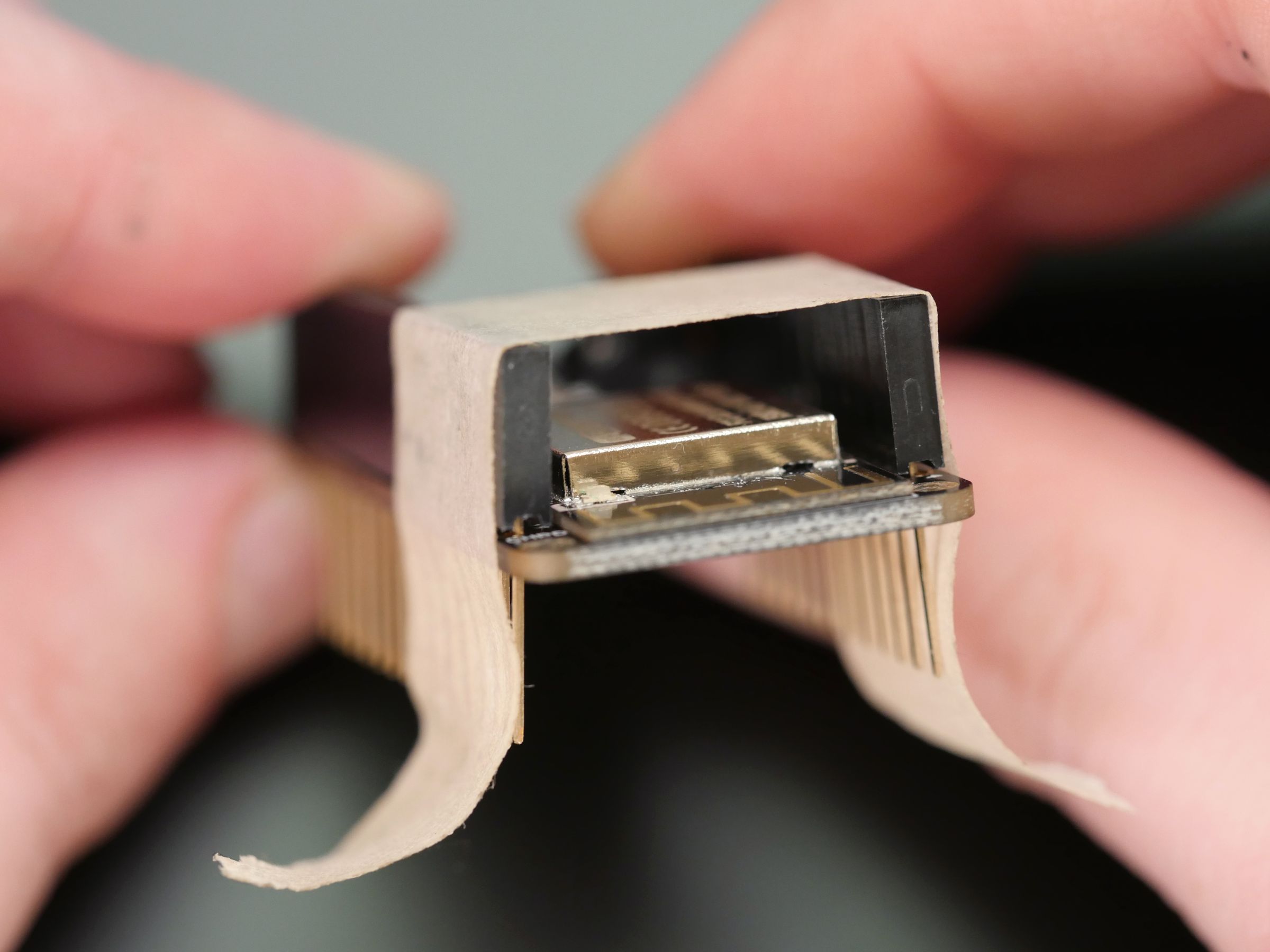

For stacking or female headers, use a piece of tape to secure the headers to the top side of the board. Tack solder one pin on each strip. If it's crooked, you can reheat this one pin while realigning the header strip before soldering the remaining pins.

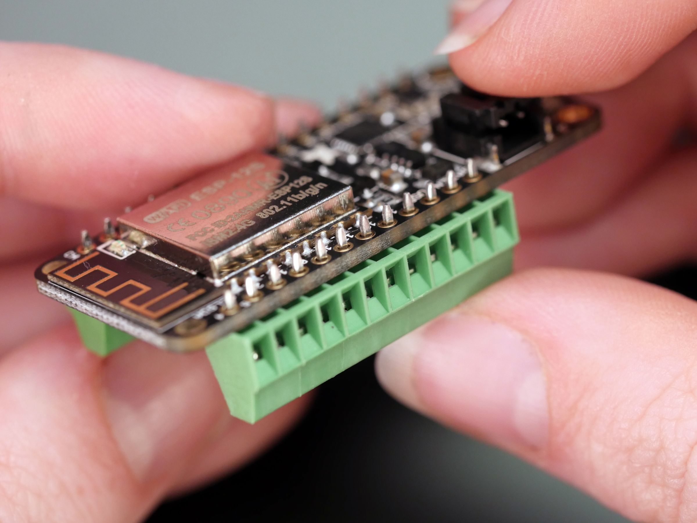

For wires you need to route into an enclosure, or for components you want to disconnect frequently, terminal block headers are a useful choice. If you want your circuit to be super flat, you may opt to attach wires directly to the board and skip headers entirely.
I usually keep a Feather Huzzah board with stacking headers around, just for prototyping. When I want to build a finalized circuit, I might choose lower profile components, but the convenience of easily plugging and unplugging components works fabulously for the prototyping stage of any project.

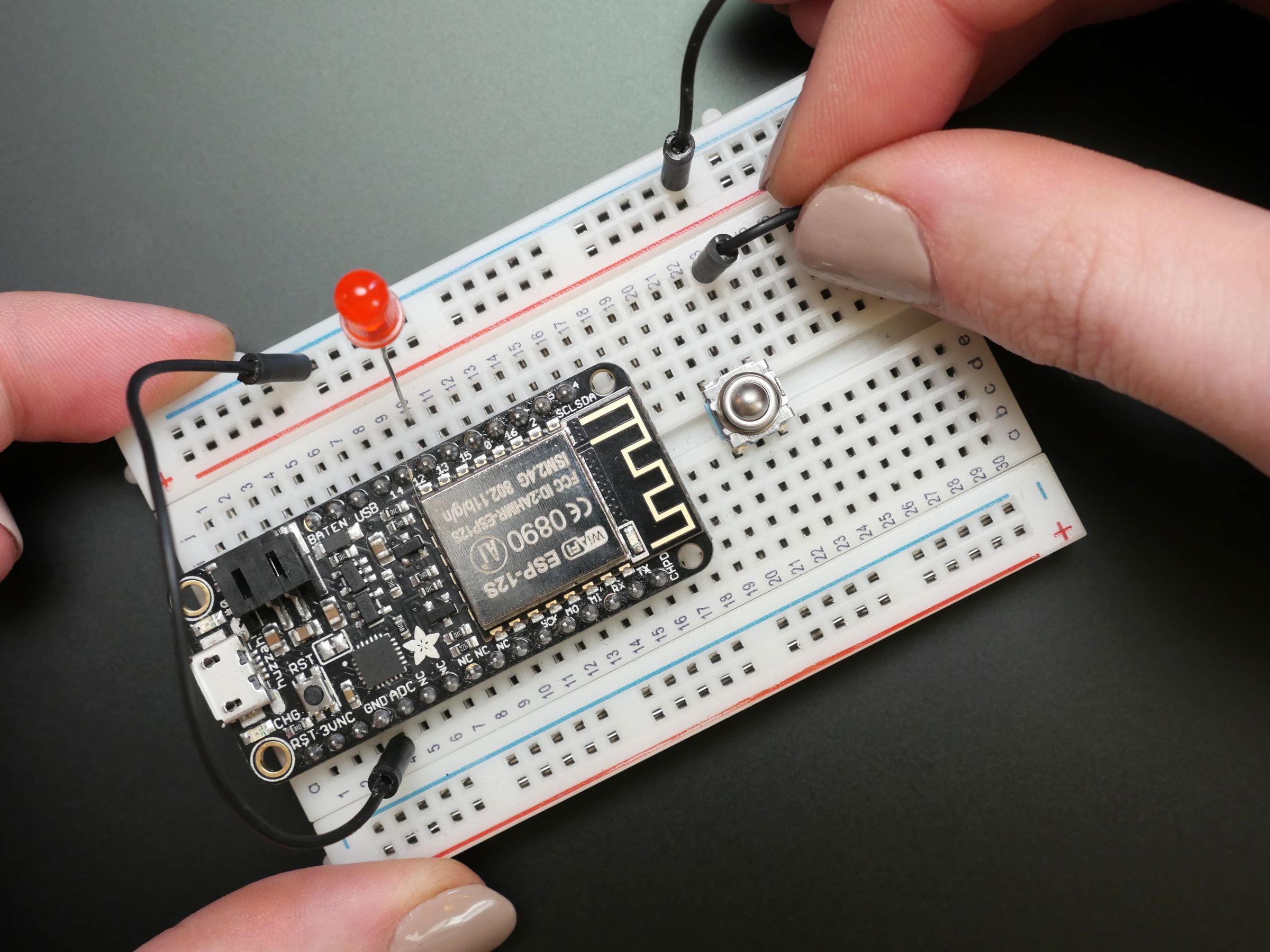

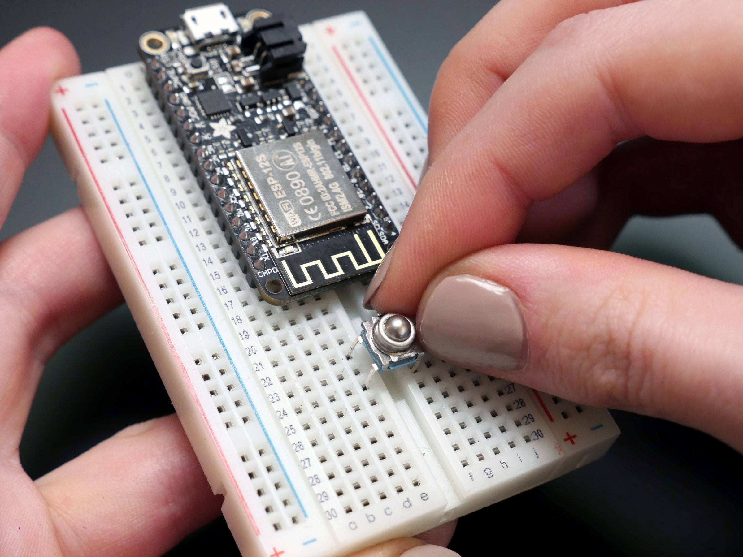

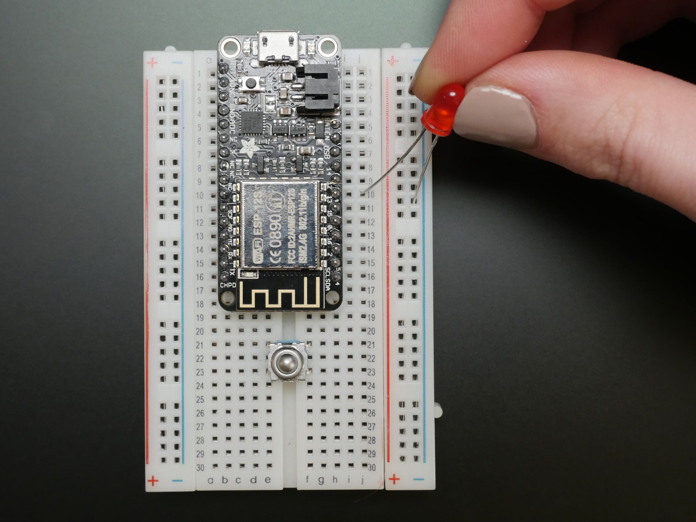

Insert your Feather Huzzah into your solderless breadboard, straddling the middle bar. Do the same with a small pushbutton. Remember to always disconnect power/USB when making wiring changes.

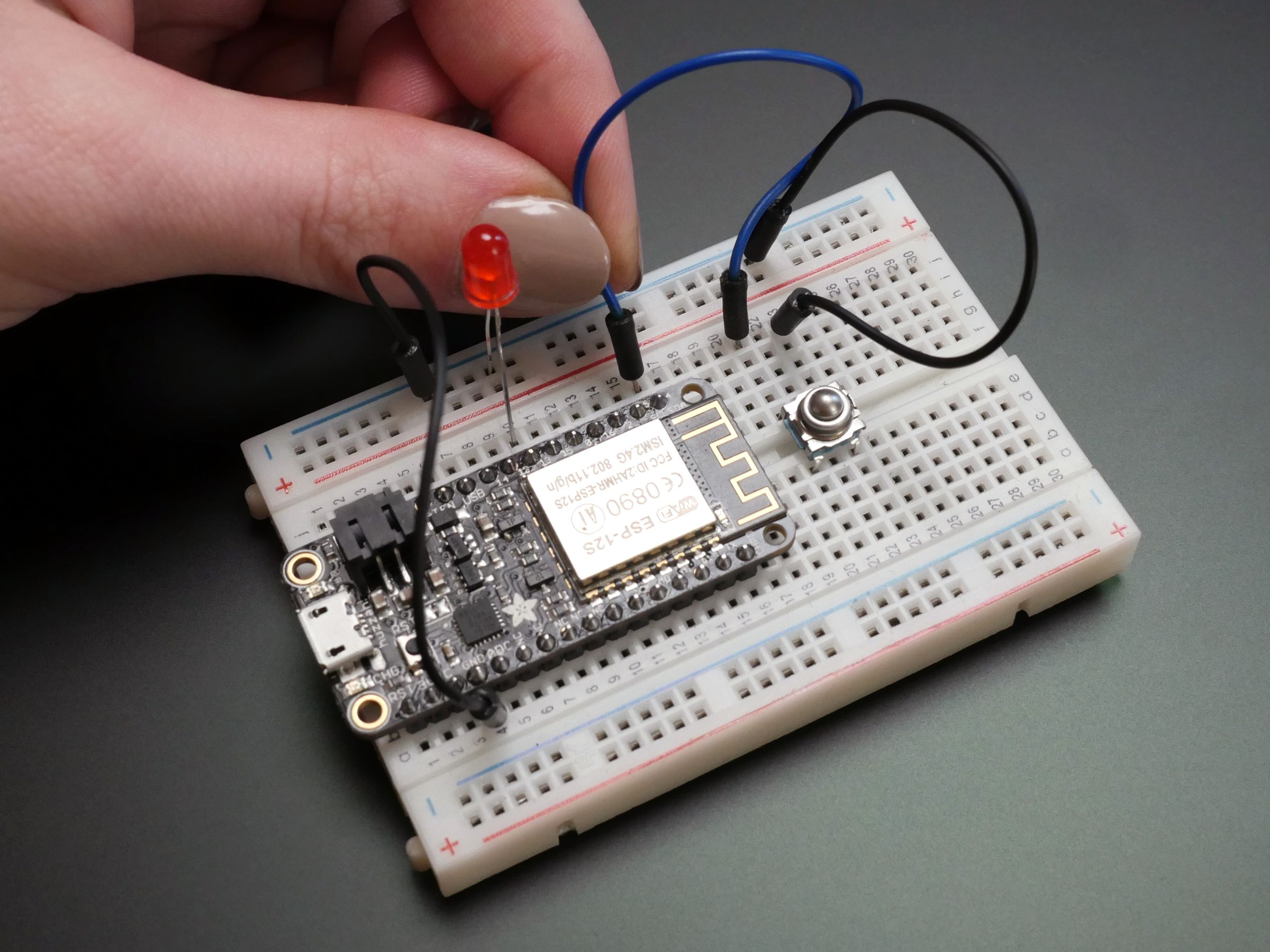

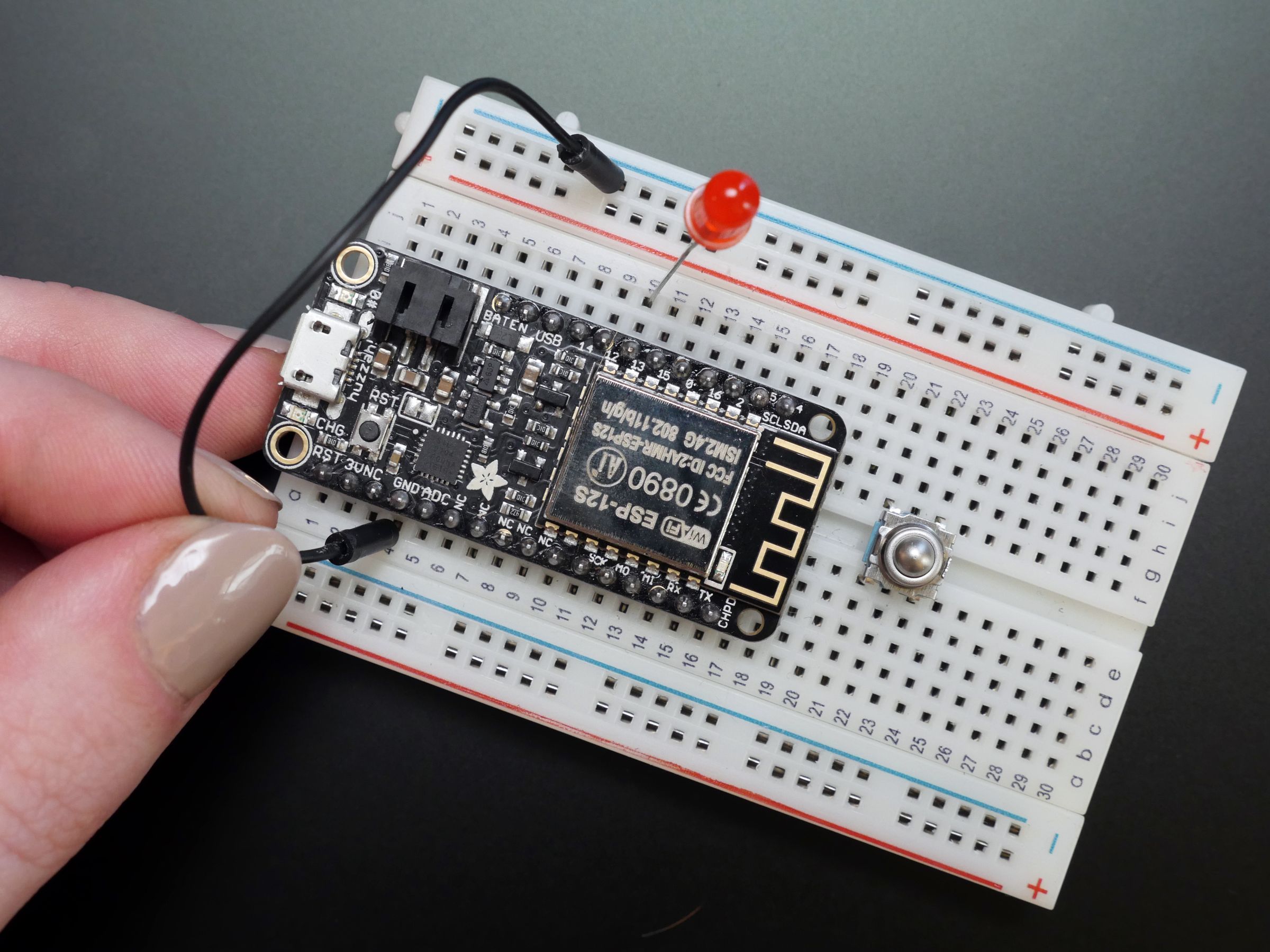

Next, grab an LED and connect its positive (longer) lead to a hole in the breadboard next to pin marked 13 on your board (D7 on NodeMCU). Plug the negative (shorter) lead of the LED into the breadboard's ground bus (any hole along the labeled blue line). The button and LED make up the most basic input and output for your first experiments. Since the Feather Huzzah is a 3V device (Arduino Uno is 5V), I chose not to use a resistor with my LED.
Let's add some wires to connect up our LED and pushbutton. First it's important to establish a common ground, so pick up a wire (any color will do but for convention I'm using black) and plug it into any hole along the ground bus and the hole next to the pin marked GND on your Feather Huzzah board.
Connect another wire from the ground bus to one of the legs of the pushbutton.
Lastly, connect a wire from another leg of the pushbutton to pin 4 on your board (D2 on NodeMCU). We'll be activating this pin's internal pull-up resistor in the code in order to read the button.

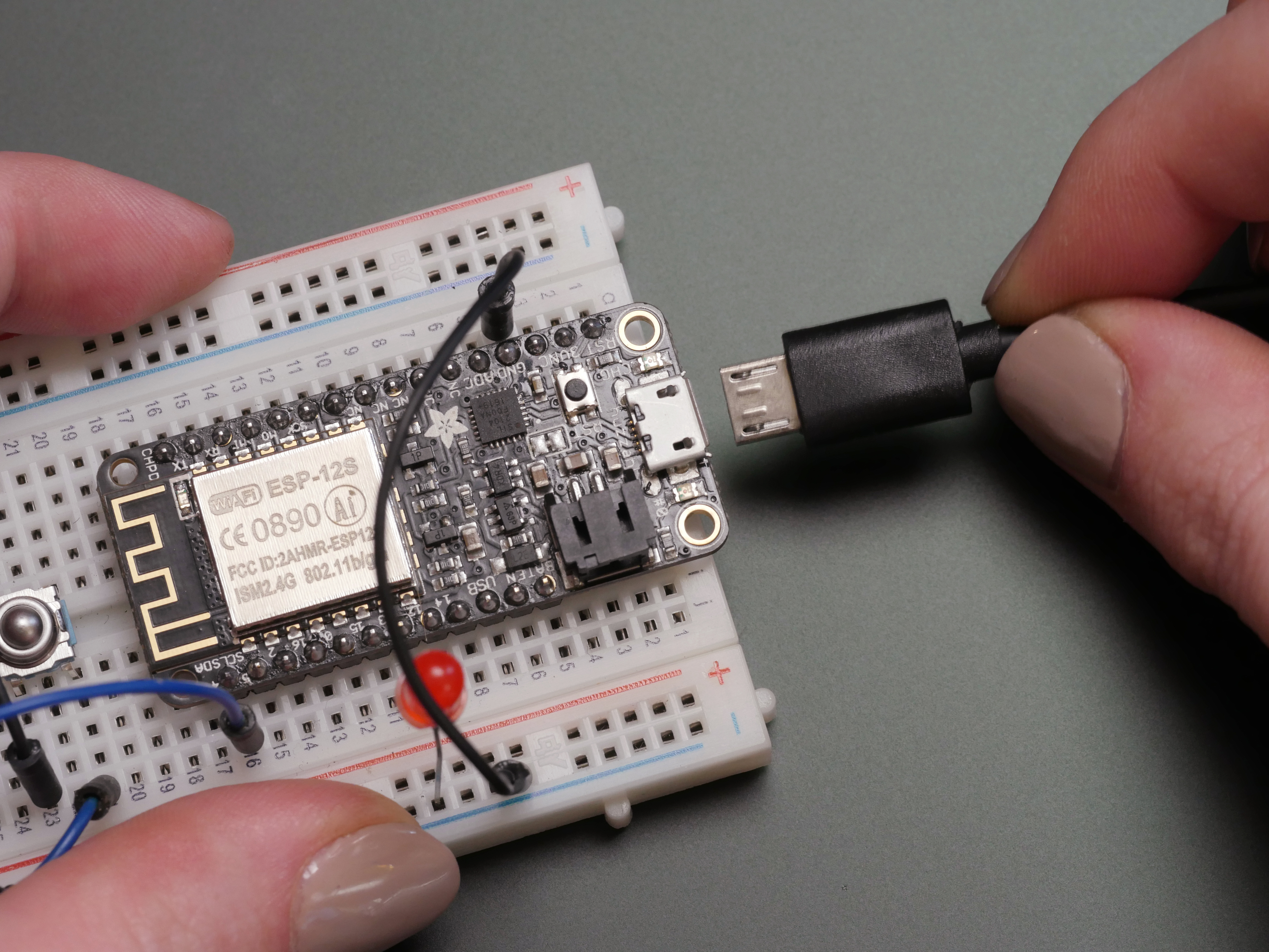

Double check your circuit against the circuit diagram, then plug in the USB cable to your computer.

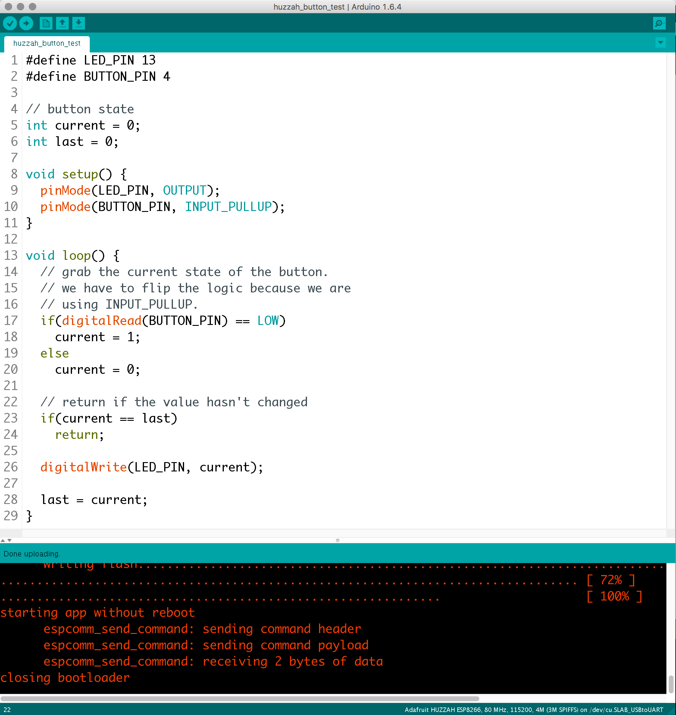

Load up this sample code (copy from below or download this step's attachment and open in Arduino); it's just a basic button-illuminates-LED circuit that will test your wiring and further cement your understanding of the software/hardware workflow.
#define LED_PIN 13
#define BUTTON_PIN 4
// button state
int current = 0;
int last = 0;
void setup() {
pinMode(LED_PIN, OUTPUT);
pinMode(BUTTON_PIN, INPUT_PULLUP);
void loop() {
// grab the current state of the button.
// we have to flip the logic because we are
// using INPUT_PULLUP.
if(digitalRead(BUTTON_PIN) == LOW)
current = 1;
else
current = 0;
// return if the value hasn't changed
if(current == last)
return;
digitalWrite(LED_PIN, current);
last = current;
Test that once the code is uploaded to your board, pressing the pushbutton lights up the LED. If it doesn't, check this list of common errors:
