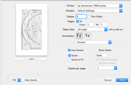

Once you have picked out your nice piece of 1x6, print the attached .pdf template on this step at actual size with no scaling on a legal size sheet of paper (8.5" by 14"). If you use a standard 8.5x11 sheet of the top and bottom may be cut off as your printer wont print right to the edges.
I've included the actual size measurements on the pattern, which should match up if you print with no scaling. The width of the pattern should fit exactly on your board. At this point you can either:
- Secure it well all the way around the edges with with masking tape or similar and plan to cut through the paper.
- Cut out just the shape from the paper, tape the shape on your board, and trace around it carefully so you have pencil lines to cut. I personally prefer this method as I like to see the wood when I am making curved cuts with the jigsaw.
A note that if you choose to make a bigger or smaller version you can adjust the print scaling - just remember if you go smaller your headphones will have less room to hang, and if you go bigger you'll need to start with a wider piece of wood.

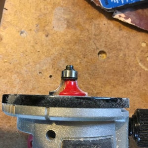

The same router bit (5/16" round over) will give you the elegant rounded shape on your stem and the round+bevel on your base. See the pictures on how to set your router fence (bit depth) to achieve the two different cuts.
Preparation
Set your router speed a bit below the max RPM listed for your bit diameter. This should be in the packaging for your bit. Clamp each piece tightly so it doesn't move (you'll need to reposition it at least once to get all the way around). Follow the directions in your router manual or online on what direction to go. Take it slow.
Stem
Set your fence so only the rounded part of the cutting edge is protruding as in the picture, and go all the way around both sides of the stem, including the notch at the top, leaving only the flat bottom that will attach to your base untouched.
Base
Move your fence slightly to allow about 1/8" of the flat part of the cutting edge of the bit to protrude as in the picture. Choose which side you want to be the top of your base, and router all the way around it.
