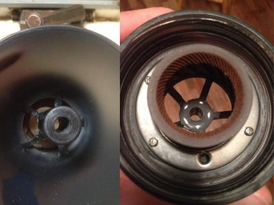

After about 6 months of heavy use, I started to get really inconsistent grinds with my Skerton. I could see that the burrs were wearing out from touching each other, so I decided I had nothing to lose by trying to modify the Skerton. There are several forum posts, products, and DIY ideas for modifying the Skerton, but I wanted to try a simple, inexpensive, but effective way to keep the burrs from touching, and to increase the consistency of the grind. This modification greatly increased the quality of grind I was getting for both fine and coarse grinds.
This method uses JB Weld to create a bushing that fits the grinder perfectly.
Disclaimer: According the JB Weld Website, JB Weld is non-toxic when cured. This does not necessarily mean that it is 'food safe.' The JB Weld does not come in contact with coffee beans, however, I don't know if regular use of the grinder would slowly wear away at the JB Weld bushing, depositing JB Weld dust into the ground coffee. I recently upgraded to an electric burr grinder, so cannot say how durable this modification is (I used JB Weld on a bolt I stripped out of an engine block on a VW Bug. 11 years later it hasn't failed, so I imagine this is a pretty durable modification for a coffee grinder...).

The smooth part of the shaft is narrower than the threaded part. I added two pieces of straw and scotch tape so that the whole shaft is about the same width. If you didn't do this, you would not be able to slide the shaft in and out of the bushing you are creating.

8) Place the hopper upside down on the piece of wood, and place the 6 inch piece of straw you cut into the well (it will be resting on tape you put on the other side). The straw will create a void in the JB Weld for the the shaft to replace, but also makes it easier to fill the well with JB Weld.

10) Use the mixing stick to fill the space around the 6 inch straw in the well. I built some up along the straw as well.
11) Put the Upper Burr Assembly and the Lower Burr Shaft together. Holding it upside down, put the end of the shaft in the 6 inch straw.
12) Lift the hopper up so that the 6 inch straw goes through, and the Lower Burr Shaft enters the well. Discard the 6 inch straw.
13) Set the hopper back on the wood, and make sure the two burrs are aligned correctly. Screw the Upper Burr Assembly back to the hopper.
14) Allow the JB Weld to cure.
