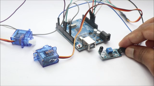

Here is the circuit diagram that i will use to build this project, The circuit is not too complex and uses only 3 components
i will start to explain the circuit one after the other

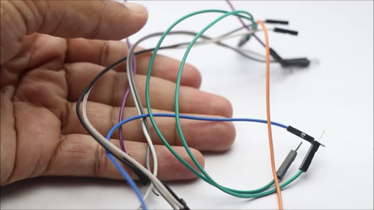

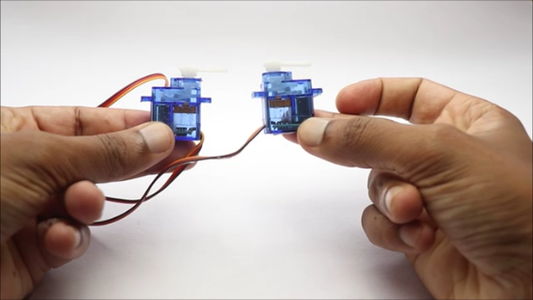

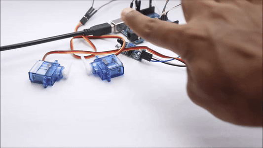

There are 2 servos that i will be using here, Two servos serves the same purpose and shares the common vcc and gnd pins

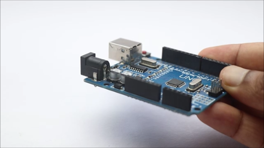

The signal pins from both the servo are connected to the digital pins d10 and d9, As far you are using the same components which iam using there is no need to use additional PCB for the circuit only the pins on arduino will do the job

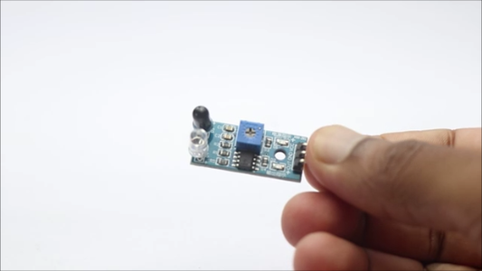

After the servos are connected to the board we can proceed to make connections with IR sensor, These modules come with 3 pins, 2 for the power supply and one for the signal.
The signal pin is connected to d2 on the uno whereas the power pins are connected to Gnd and Vcc
After you make these connections on the uno we can head over to uploading the arduino codes, Dont worry all you have to do is copy and paste the below codes on the arduino ide and click on upload.
If you face any issues at the time of upload, Double check if the libraries are installed on the ide, if not you can install them first and later proceed with the upload.
After the program is on the board you can test it instantly by placing the hand infront of the sensor

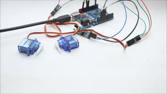

There are 2 options to power this project, One is by the default USB programming cable via any power bank and the other one is by external power source.
External power source is via an adapter, Both the ways are equally as good and you can choose any one as per the resource availability.
If the servo are not installed with horns, Insert it and secure them with screws.
Now if you place your hand infront of the IR sensor, Adjust the pot screws on the IR board untill the sensing distance is between 1 and 3cm.
when the object(in our case im using my hands) is detected the servos should move and be in the same position untill the circuit is completely turned off and on again.

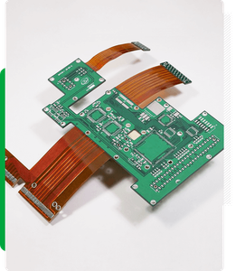

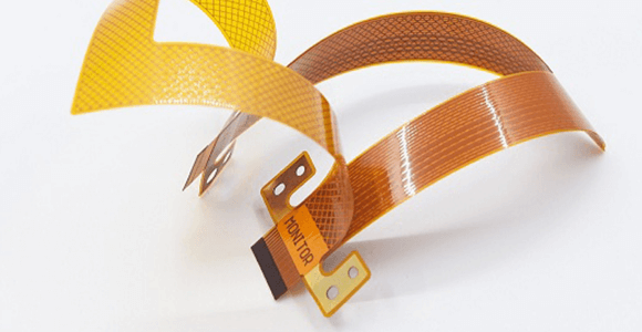

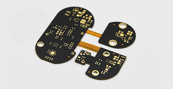

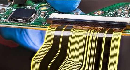

Check Here for Rigid-flex Pcbs with this your circuit becomes flexible! I have added the images to this step kindly check.
A revolutionary solution that combines the best of both rigid and flexible circuitry to elevate your electronic projects to new heights.
With their expertise in advanced manufacturing techniques, they offer a seamless integration of rigid and flexible components, ensuring enhanced reliability, durability, and space-saving benefits.

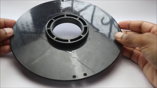

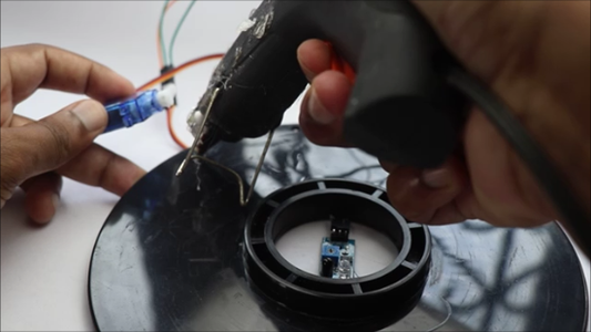

Electronics that were tested will now be put to practical use in this step, I will start by adding the IR sensor to the base first you can use hot glue or double sided adhesive for this purpose.
For the strong body, I made use of my PLA filament roll, You can use other alternatives like plexiglass or wood for this purpose.

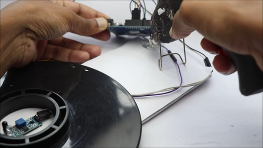

Hide the IR sensor below this, This is because when the mouse runs over this sensor the servo will be activated, So i would suggest you follow this placing.
Use a decent amount of hot glue to seal all the edges properly, After this is dry mark the area where you will be placing the servos.
The distance between the 2 servos depends on the size of the cup that will hold the mouse, Use hot glue to seal the servos to this base.
Hide the wires using the glue so that there will be no problem with the circuit while the mouse is caught and make some movements.

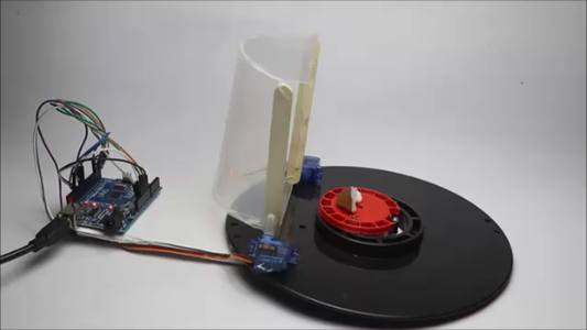

The mechanism behind the working is simple, There are total 2 servos that will contribute to closing the lid when mouse is detected.
Since the servo horns are too small i will extend those with popsicle sticks.
start by attaching the horns to these sticks and later connecting them to servo shafts, Repeat the same step for other servo also.

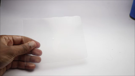

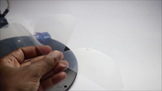

Now make ak arch using plastic sheet, This plastic sheet i recycled from my tool box kit, one added advantage here is the plastic sheet is flexible and on the other hand it is strong also.
Use hot glue to stick these to the popsicle sticks, allow it to dry completely and now cover the sides using same material until the cup is totally covered from all end and looks like a case.

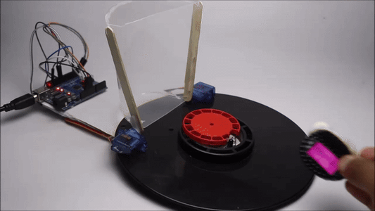

The working is simple all you have to do is select the favourite food of your mouse!
Keep it on the panel, The lid opens up automatically when you power on this device, I will be using a power bank to power this mousetrap.
Keep this trap on the area where you expect the mouse, The mouse when it comes to have the food will be trapped by the lid and now the trap remains closed till the uno reset button is pressed or when the power supply is turned off and on again.
I kept the lid transparent to have a look for you guys, You can also replace this part with some other materials depend on the size of the mouse!
