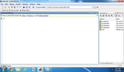

1) In the main page of Matlab in the work space the scope data are available.
2) Get the data from scope.
3) Save it to Excel sheet.
