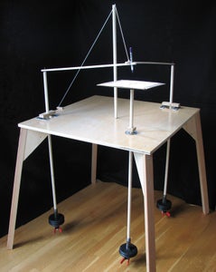

I researched harmonographs and found that they are mechanical devices that use the motion of two pendulums tied to a drawing device to trace geometric designs on a drawing surface. When an additional axis of motion is created by allowing the drawing surface to rotate, more complexity is introduced to the figures produced by the machine. A picture of such a machine can be seen above (courtesy: http://www.karlsims.com/harmonograph/).
