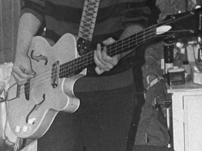

Introduction: Harmony H22 Bass.
A 1964 Harmony H22 Bass....
...and It's having a fantastic life - I'm happy to have been part of it. There's no doubting the love that has been bestowed upon this guitar but It has gigged and partied with the best of 'em. The feckless have walked backwards into it and rested it, precariously. Along the way it has sustained some quite serious damage, particularly to the bottom edge of the semi-acoustic body, around the jack socket. Small parts have been lost. Some old parts have worn out and now it's time for an overhaul.
Thank you, KC, for selecting and forming the repair-piece.
This lovely old guitar has taken a dramatic and rather romantic journey to arrive in my care. I'll do my utmost as an obsessive-compulsive and infernal DIY tinkerer, to revive it, if not to an immaculate, original condition then hopefully, at least, to a familiar state, without taking away it's character and charm. (that's me covered).
