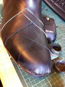

The boots started off as a pair of cheap rubber riding boots I found on ebay. Looking at the reference of the real costumes, these seemed like a perfect base, even down to the little heel.
These are fairly simple to do, but they do take a bit of time. I found some cheap pleather (faux leather) online, then started to glue pieces onto the boots. I used a good qulaity contact adhesive for this, as it's good with rubber and fabric.
Cut some pleather pieces to size, then apply a thin, even layer of glue to both the boot, and the pleather piece. Wait for it to dry, then carfully place the pleather piece onto the boot, making sure to press down the edges. The toe piece, where I started, can be difficult to get into place, as it needs to streach over different angles. The following strips are all much easier. Keeping an eye on the reference photos, I layered up strips of pleather, gluing them all on as I went along. Take a look at the photos to see the process.
Once all the pieces were in place, I trimmed off the top of the boots, which were slanted, to make them straight. At this point, the lining inside the boot started to come away, so I simply used some good quality double sided tape to fix it back in place.
The next thing to do was to dirty them up a bit, I used some black and brown acrylic paints for this, slopping it on, then wiping the excess off, leaving thin layers stuck in all the seams.
The final thing to do for the boots was to tie on the little leather lace around the ankle.
