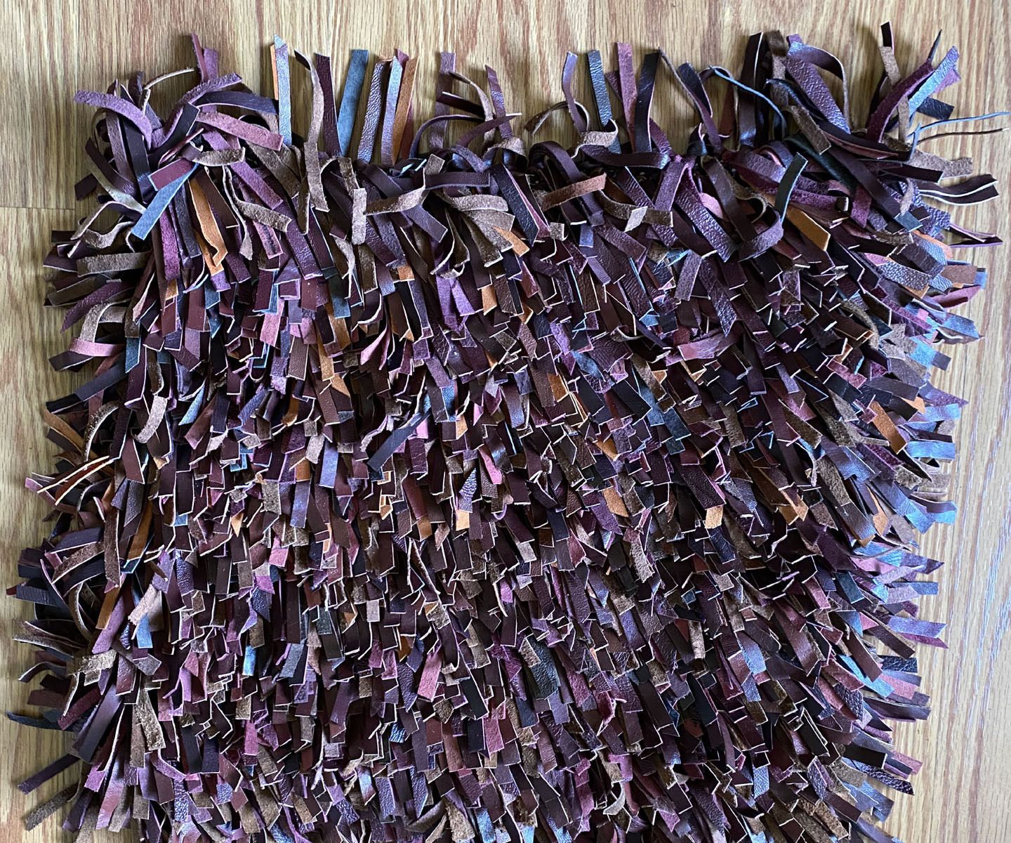

The Monster Book of Monsters was constructed the same way as the other hardback bindings using a heavy, durable paper for the covering instead of leather. The teeth, tongue, eyes and tentacles were made from polymer clay using the "flex" type for the tongue and tentacles. The teeth were made and cured first, then the gums were added to the teeth and attached to the cover using white glue and cured. The tentacles were then made and attached to the cover using PVA glue and the book was again "cooked" to cure the clay. The tongue was made separately and glued to the inside of the back cover. After all of the polymer clay work was done, the cover was attached to the book block. Finally, the eyes were glued to the cover of the book and a rabbit skin was fitted to the book and cut to size with a slit being cut where the eyes were located. The rabbit skin was glued to the cover. Hair was snipped off of scraps of the rabbit skin and glued to the backs of the tentacles to give them a furry appearance. I recommend that all work done with the rabbit skin be done outside because you wind up with hair on everything! The lettering of the Monster Book of Monsters was worked out in photoshop from a screen capture of the book in the movie which I found on the internet. It was then printed on heavy paper and the letters were painting using a gold metallic paint. The area around the letters was painted with a grey paint to give the same appearance as the book in the movies. The pieces of the book title were cut out and the hair of the rabbit skin was cut as close to the skin as possible in the areas where the title pieces were to be placed, frequently checking the placement and being careful not to cut away too much of the hair. The book labels were then glued into place using PVA glue. The belt was made by cutting a strip from a piece of new heavy tooling leather and a buckle recycled from a thrift shop belt.
