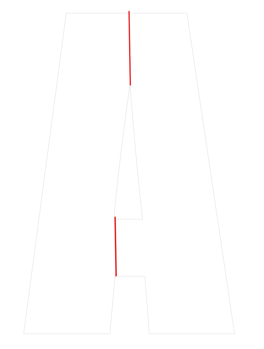

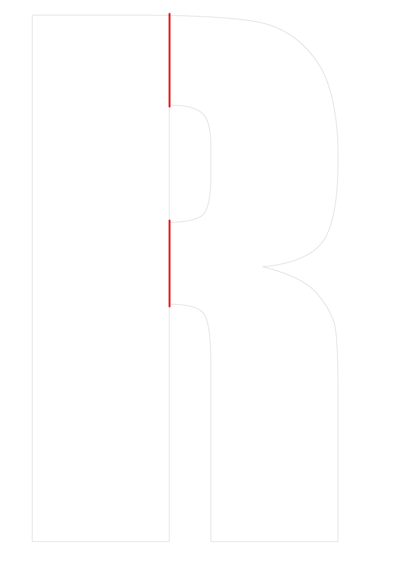

Step 3: Cut Out Letters
Now it's time to cut out the letters. Cut your patterns to a size that will fit on your wood pallet blanks without hanging over the edge. Then using the spray adhesive, attach your letter patterns to the pallet wood blanks.
Next, use your band saw or jig saw to cut out the letters along the outlines on your pattern. For the letters with inside sections like the "R" and the "A", I just cut the letter in half as straight as I can (see red lines in images). Then cut out the middle section. When you're finished, just glue the two halves back together using Tite Bond III, which is waterproof. Take a look at my finished "A" and "R"... you can't even tell.
Finally, use your sander to clean up the edges and make them nice and smooth.
