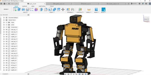

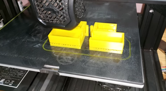

Step 1: 3D Printed Parts
I have used 3D Printed parts each part of the robot. I chosen orange and grey color for the robot. I have printed all the parts in Ender3 V2 3D Printer. Using the basic Cura setting I have printed all the parts in 20% infill (0.2 mm nozzle). For better look you can smoothed the 3D Printed parts using sand paper.

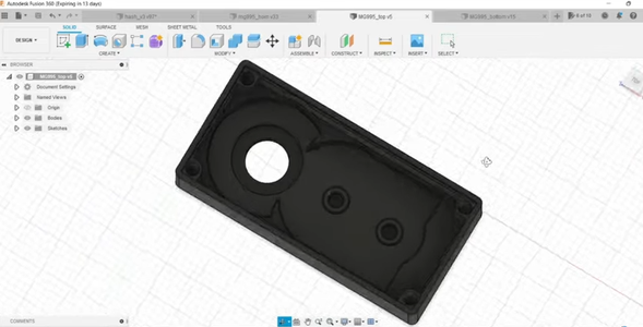

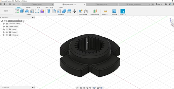

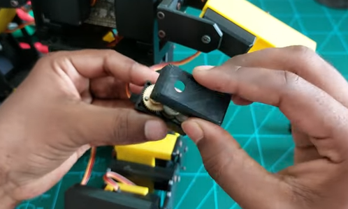

Step 2: Custom Servo Horn and Servo Head
I made a custom servo horn and also a custom servo head specially for this robot. This allow me screw the servo to the robot body, and also reduces the space.

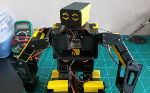

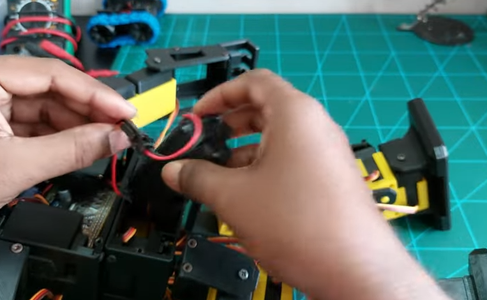

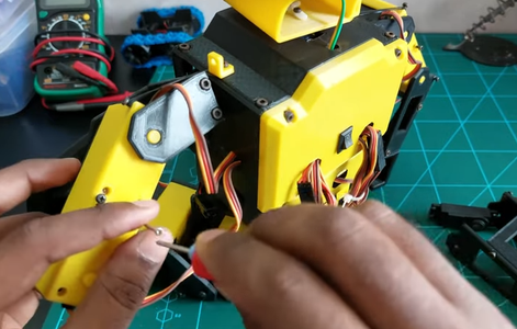

Step 3: Assembly of the 3D Printed Parts
Assemble all the parts as shown on the image slide.
Assemble each part with the servo and then to individual parts. First assemble the leg (more about the robot leg) and then the robot body. Make sure to mark each servo wire accordingly for easy understanding.
For enthusiasts who are willing to know the full assembly process you can watch the Hash Humanoid v2build.
