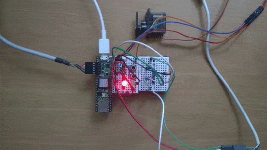

Step 6: Assemble the Device
That shouldn't be hard. The hardest part of the process (in my opinion) is to map the PS/2 port and connect it the right way (assuming you would even connect it).
As for the possible component replacements: you can replace the resistors connected to buttons with 2.2k - 10k resistors.
According to the PJRC official websitethe digital pins of Teensy 4.1 are not 5V tolerant. Because of that, I would strongly advise you to double-check that you've assembled the circuit correctly.

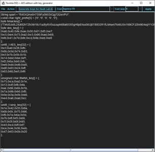

Step 8: Generate Keys for the Firmware
To make the unauthorized deciphering of the encrypted keys (that open the lock) computationally infeasible - It is crucial to generate your own encryption keys and never reuse them.
It's entirely up to you how to generate the keys. I can only offer you an option to do so.
I've modified one of my previous projects to work as a random number generator, the generated output seems "random enough" for me, but I haven't run any tests. So, I can't guarantee that it's random.
Use it at your own risk!
To generate the keys - launch gen.exe from the "Teensy 4.1 Edition\V1.0\Untested RNG" folder and click the "Generate keys for Hash Latch" button. The background turns from dark gray to light gray when you press that button.

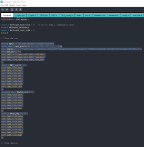

Step 9: Modify the Firmware
Open the "Firmware.ino" file from the "Teensy 4.1 Edition\V1.0\Firmware" folder, and then replace my keys with those you've generated.

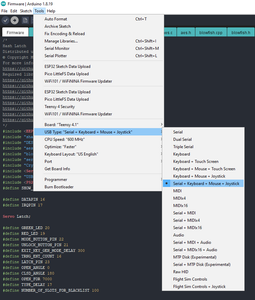

Step 10: Flash Teensy 4.1
Upload the firmware from the "Teensy 4.1 Edition\V1.0\Firmware" folder into the Teensy. Don't forget to set the value of the "USB Type" line to the "Serial + Keyboard + Mouse + Joystick."

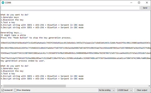

Step 12: Generate Keys for the Lock
To generate the keys for the lock: open the Serial Terminal, Enter "1" to the text field, and then press "Send" button.
The key generation process might take a while
Press the "Mode" button to stop the key generation process.
Even though this device can generate a lot of keys, the maximum number of available keys is limited.
After the device tries all of the 95^10 combinations, it will stop the key generation process and show you the "No more combinations to try!" message.
I left the device for five minutes and obtained these ciphertexts (encrypted keys).

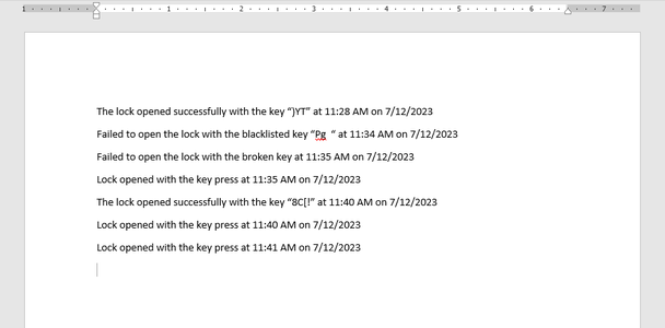

Step 14: Set Up the Software to Keep Logs

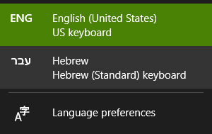

Unlike its predecessor, the hash latch can act as a USB keyboard. That enables you to keep logs. To keep the logs, first and foremost, ensure that the keyboard layout is set to English (in case you have several of them). Then create an empty Word document, and click into the textbox area.
