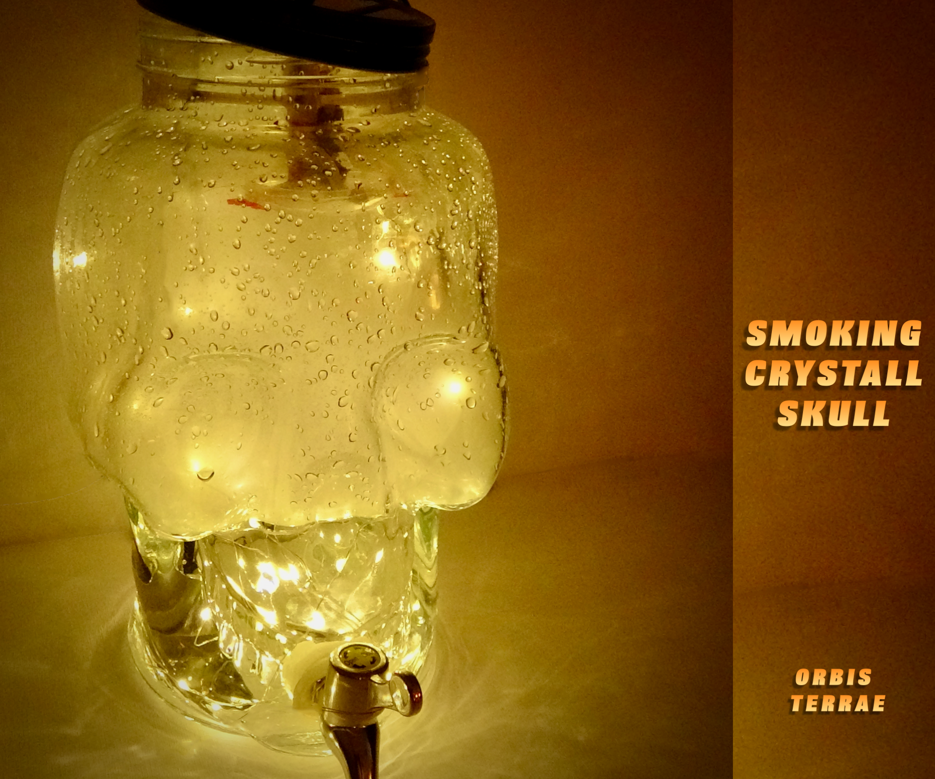

This is an evolution of my previously crafted Smoking Crystal Skull project. It's using similar components and skills (electronics, programming and basic crafting with carton). The cost is cheap, well under $50, and pretty easy to build - I took me a couple of evenings to create this Haunted Watering Can.
