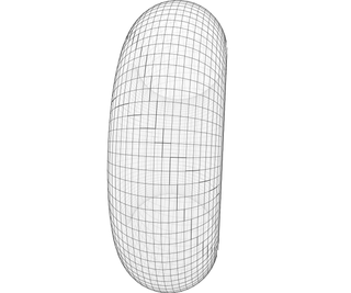

Step 2: Step 2: Design a Bagel Torus
Bagel is the most common torus. In Solidworks, A Bagel Torus can be formed by sweeping a profile through circular path. Here, I choose a circle as the profile. And if the diameter of the circle is equal to the diameter of the inner hole, you will get a very beautiful Bagel Torus shown in the photo. And after this, we are going to cut this Bagel into different shapes in the following steps.

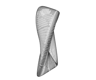

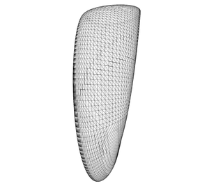

Step 3: Step 3: Design a Mobius Strip
A Mobius Strip is ideally a surface with only one connected side. Imagine if there is an ant on the outside surface of a Mobius Strip, it can just hike through a certain direction along the strip to the same location on the inside surface without stepping over any boundary, and following the same direction of the path, the ant can travel back again to the same location on the outside surface.
The Mobius Strip can be formed by half-twisting a normal strip, namely twisting one end of an open strip by 180° and connecting the two ends of the strip. In Solidworks, a Mobius Strip can be formed by sweeping a profile through two semi-circular paths. In each path, the profile should also be twisted by 90°. So along the whole sweeping path, the profile is twisted by 180°. Here, I choose a flat ellipse as the profile so that we can obtain a solid Mobius Strip in Solidworks and it is feasible for 3D printing.

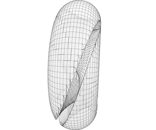

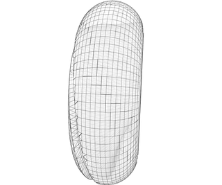

Step 4: Step 4: Construct a Mobius Space Inside a Solid Bagel
Imagine you have a bagel and you use a knife to slice the bagel through its reference circle. If you simply follow the above process, then you just cut the bagel into two separate pieces. But if you also carefully flip your knife by 180° until the complete cycle, you will still get a single bagel but with a loop tunnel inside. Assume your knife is thick enough, then what kind of materials or space does it cut off? It is actually a Mobius Strip as we mentioned.
The above geometry is really interesting. It is somehow like a model of the galaxy or universe. If you squeeze a ball with suitable size into the Mobius Space in the solid Bagel Torus, then in theory, the ball can roll freely through the whole inside loop without moving to the outside surface of the Bagel Torus.
In Solidworks, we choose “Swept Cut” to achieve this feature. Also, you can expand your imagination and make the geometry more charming. For example, you can redesign the Bagel Torus to be uneven in orbital diameter and then cut it by the same Mobius Space. Now you will obtain a shape like a sea shell. So try to create something better after the going through this step.

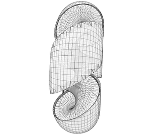

Step 5: Step 5: Make a Full-twisting Strip
If we twist one end of an open strip by 360° and connect the two ends of the strip together, now we obtain a full-twisting strip. In Solidworks, we use “Swept Base” to sweep a flat ellipse profile through a circular path by adding the twist value as 360°. This time, you will find that the developed geometry actually has two surfaces.
