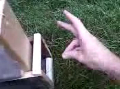

The problem is age-old and simple: you planted a summer vegetable garden and some pesky wabbit is chewing it all to pieces. Have fun stopping Thumper by going Davy Crockett on his cotton-tail with a humane rabbit trap.
How it works...
Two days after it was set...

Fasten the top of the box. Leave the top about 2 inches shorter than the bottom, as in the picture.
For this step, we'll need the narrow piece of board for the trap door and 2 skinny strips of wood.
Cut 2 strips of wood to serve as a housing for the trap door. One should go across the top of the box and another inside the entrance to the box.
Nail the 2 strips as shown in the pics. Leave plenty of space for the trap door to drop freely.
