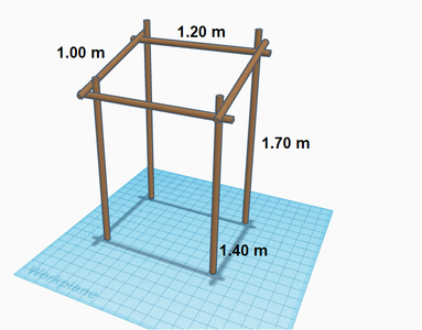

This Tiki Bar is designed to be placed on top of a table. In this way, the table will be the supporting structure, on which you can prepare fantastic snacks and cocktails, underneath an awesome Tiki Bar.
Obviously, the measurement of the different bamboo stick are refereed on which table you will use.
In the image, you can see an overall of the structure. In the first image, I added the measure of the bamboo stick that i used. In the second one, you can see how I reinforce the structure, for make it more solid.
The two CAD are created with Tinkercad.

First of all, mark with a pencil the necessary length on each bamboo stick. Then, cut them with the hacksaw. At the end, you will have:
- x2 1.70 m long stick
- x2 1.40 m long stick
- x2 1.20 m long stick
- x2 1.00 m long stick
Make sure to have extra bamboo sticks for later (it will need for reinforce the structure!).

Start from the front of the Tiki Bar:
take your 1.40 m bamboo sticks for the two columns and one of the 1.20 m stick for the beam between them.
With the scissor, cut a long piece of string (as 50 cm long or more) and start to tie two stick together: for make the process easily, make first a simple knot with one of the two string end. Then, start to wrap the string around the cross of the two stick (I used a sort of Diagonal Lashing knot, for more information, search some Instuctables or on YouTube ;) )
Be sure to use enough force for join the two pieces well.
Do the same for the other column. At the end, you will have a U structure, that will be your Tiki Bar facade.
Now, you have to do the same for the back of the Tiki Bar. This time, you have to use the 1.70 m long bamboo sticks for the column, and the last 1.20 m long stick for the beam.
When you have the two U shape structure, you have to join them together: for that scope, use the 1.00 m long bamboo stick.
You finally build the main structure of your Tiki Bar!
