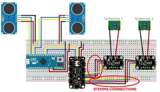

At the heart of the device lies an Arduino Micro, a small and compact microcontroller board. The Arduino Micro serves as the central controller: it reads distance data from the ultrasonic sensors, processes that information, and sends appropriate signals to the haptic actuators in real time. Its small footprint and low power consumption make it well-suited for integration into this lightweight system [7].
All actuators and sensors are connected to the Arduino Micro. The attached schematic provides an overview of how these connections should be assembled. To make the setup easier to follow, we have broken it down into individual tasks. (See step 3 → 5)

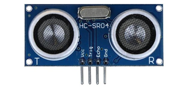

Step 3: Ultrasonic Sensors
We begin with the HC-SR04 ultrasonic sensor. Ultrasonic sensors are used for measuring distances with high accuracy, making it well-suited for obstacle detection applications. It operates by emitting ultrasonic sound waves and measuring the time it takes for the echo to return after bouncing off an object. This time-of-flight is then used to calculate the distance, based on the known speed of sound in air.
Each HC-SR04 module includes a transmitter and receiver integrated into a single unit. The transmitter emits pulses at 40 kHz, and the receiver detects the reflected signals. The sensor operates within a voltage range of 4.5 to 5.5V and can measure distances from 2 cm to 400 cm, with a resolution of approximately 3 mm.
The module includes four key pins:
  1. VCC: Supplies power to the module (4.5–5.5V).
  2. GND: Ground connection.
  3. Trig: Trigger pin that initiates the ultrasonic pulse when set high for at least 10 µs.
  4. Echo: Echo pin outputs a pulse whose duration corresponds to the time-of-flight of the ultrasonic wave.
Connect these pins to the Arduino micro as followed (see also the breadboard figure):
Sensor 1:
  1. Vcc → 5V (red)
  2. Trig → D10 (yellow)
  3. Echo → D9 (blue)
  4. GND → GND (black)
Sensor 2:
  1. Vcc → 5V (red)
  2. Trig → D12 (yellow)
  3. Echo → D11 (blue)

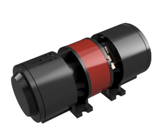

Drake Haptic Actuators:
The Drake LF haptic actuator, also known as a TacHammer, is a compact and high-precision haptic motor designed for modern tactile feedback applications. Unlike traditional actuators that rely on springs or flexible structures, the TacHammer employs a solid-state magnetic suspension system. This innovation allows it to produce strong, percussive vibrations with exceptional consistency and responsiveness, while maintaining a lightweight and durable form factor. Ideal for wearable and portable devices.
Drake actuators are categorized by two key performance metrics: their effective frequency range and their peak output, which is measured in root mean square acceleration (Grms) at resonance. The LF model is optimized for low-frequency operation, making it especially suitable for applications that require clear and distinct tactile cues.
In our project, the Drake LF's compact size and reliable vibration output make it a natural fit for our headband design. Its ability to deliver directional, percussive feedback enables users (particularly those with visual impairments) to intuitively sense the location and proximity of obstacles in their environment. [9]

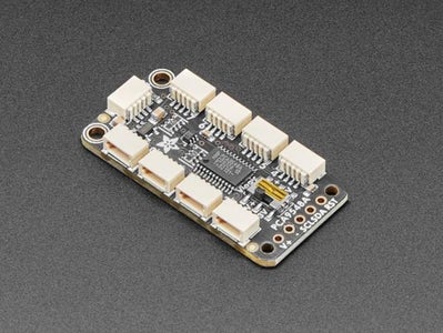

Step 5: PCA9548 Multiplexer
Next we go to the PCA9548 multiplexer, to better understand how the multiplexer works we first introduce you to the I2C Protocol.

PCA9548 multiplexer:
Now back to the PCA9548 multiplexer (see figure), this module allows you to connect multiple I2C devices to a single I2C bus, even if they share the same address. This is especially useful when working with identical I2C components, like multiple DRV2605L haptic drivers, that would otherwise conflict due to address overlap.
The multiplexer has eight independent, bidirectional I2C channels. It routes the main I2C bus (SCL/SDA) to any combination of its eight downstream ports (SC0/SD0 through SC7/SD7), which are selected by writing to the multiplexer’s control register over I2C. This setup prevents address conflicts and allows sequential communication with multiple identical devices.
The I2C address of the PCA9548 can also be configured by connecting the A0, A1, and A2 address pins to either GND or VCC, giving you up to 8 possible address combinations—ideal when using multiple multiplexers in one system.

Connect these pins on the PCA9548 to the Arduino Micro as followed:
  1. Vcc → 5V
  2. GND → GND
  3. SDA → SDA (pin 2 on Arduino Micro)
  4. SCL → SCL (pin 3 on Arduino Micro)
DRV2605L Connections:
Connect the SCL/SDA, VCC, and GND of each DRV2605L to a separate channel on the PCA9548 with the STEMMA QT wires:
  1. DRV2605L #1 → Connect to Channel 0 (SC0/SD0)
  2. DRV2605L #2 → Connect to Channel 1 (SC1/SD1)
Address Handling:
Both DRV2605L drivers have the same default I2C address (0x5A), so using separate channels via the PCA9548 avoids address collisions. This can be done in the software. Here you can find a conceptual Arduino Code Example:

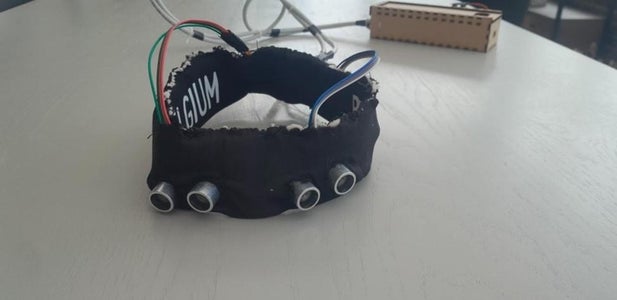

Step 8: Wearable Design
For our design we chose a headband to attach our ultrasonic sensors and haptic actuators. This makes it easy for the user to put the device on. The sensors and actuators are connected to the hardware enclosure via two Ethernet cables. This enclosure houses the Arduino Micro and all other necessary hardware components, as described in “Step 2: Hardware Overview”.

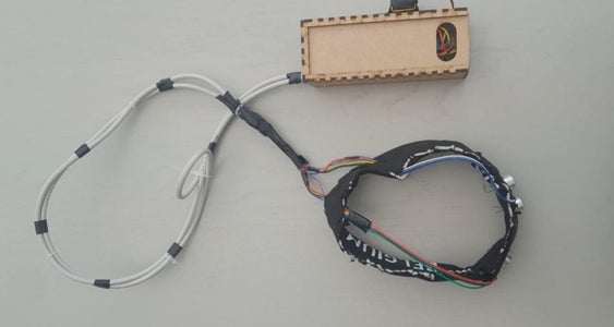

Wiring and assembly:
To integrate the components into the headband, we made a slit along the fabric to route the wiring internally, allowing the cables to exit at the back. Jumper wires were used to connect to the ultrasonic sensor pins, although soldering is also a viable option for improved durability.
In total, twelve wires are needed:
  1. 2 × 4 wires for the ultrasonic sensors
  2. 2 × 2 wires for the DRV2605L haptic actuators
To organize and protect these wires, we used two Ethernet cables (each containing 8 wires). Alternatively, a VGA cable could be used as it also contains sufficient wiring. All connections are soldered and insulated with wire tape.

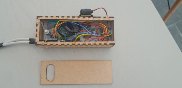

Inside the hardware container, the DRV2605L drivers, PCA9548A multiplexer, potentiometer, and Arduino Micro are connected according to the schematic in Step 2. A 9V battery is connected to the Vin and GND pins of the Arduino to provide power when the device is not connected to a PC.

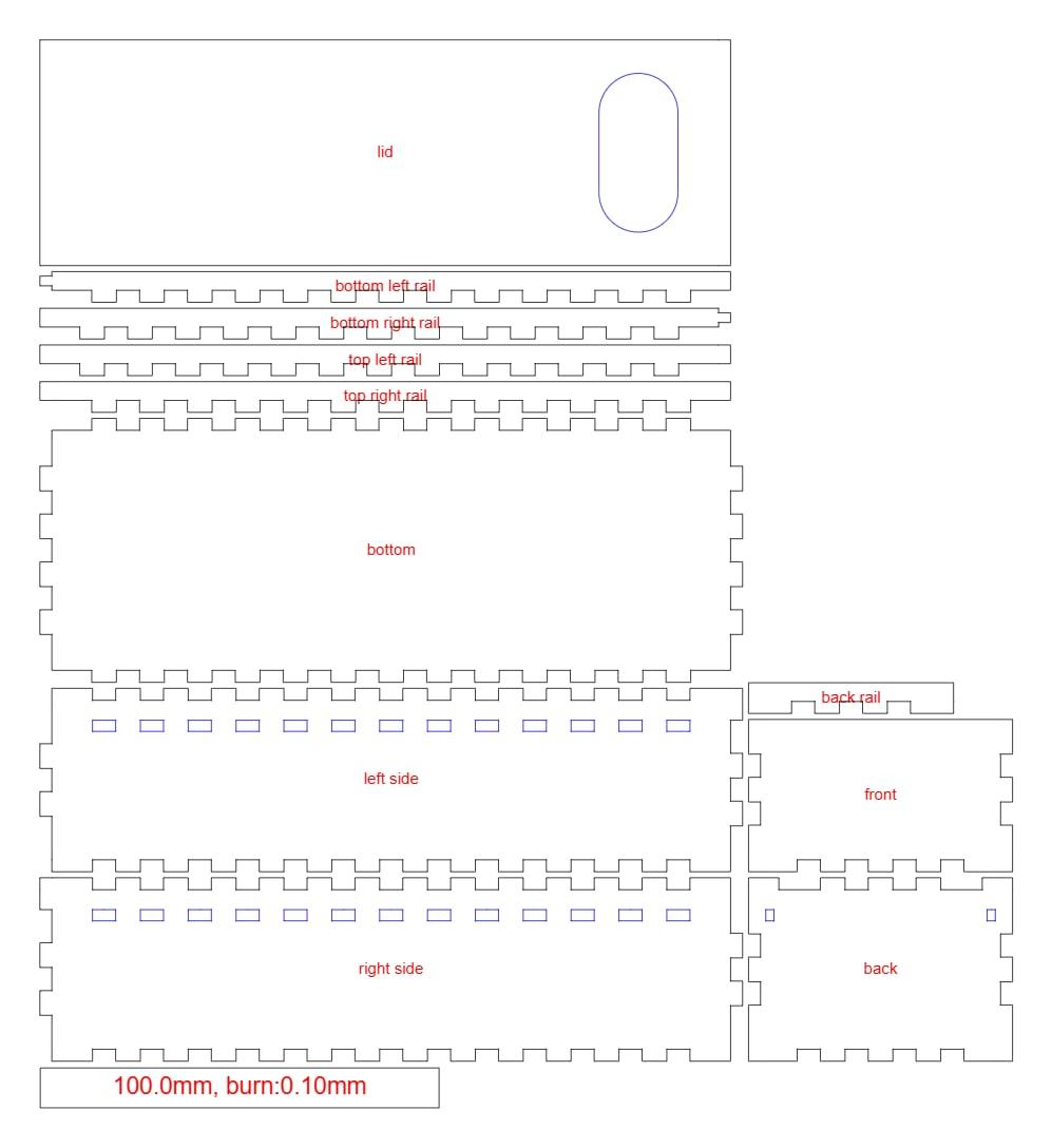

Hardware enclosure:
Then for the hardware enclosure we made a laser cut design as shown in the figure above. You can replicate this by downloading the file attached at the bottom of this step or you can make one yourself.
