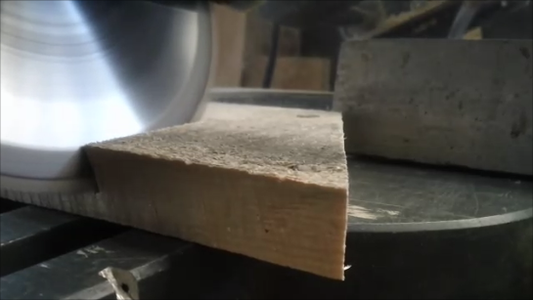

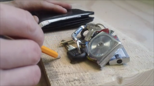

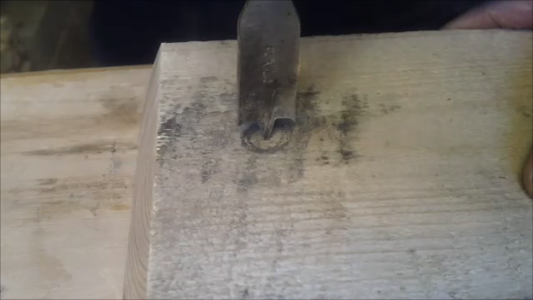

I used a small piece of leftover pallet wood from a previous project as my base. I cut off both ends at 30 degrees or so. Next I used a 3/4 inch bit to drill a hole for the headphone holder to sit in. I was careful not to drill all the way through the base. Then simply lay out whatever you normally have in your pockets and outline them with a pencil. In my case, only a wallet, keys and an ipod.

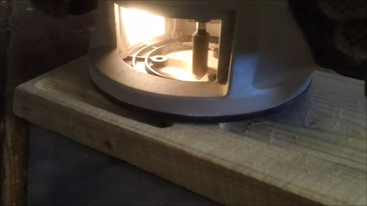

With a half inch straight bit in the router, I then routed out the places i had marked. The half inch bit works perfect to make a groove to place your ipod in. This grooved will work for most smart phones, or any cell phone for that matter. So I made a groove just behind the circle that my keys will go in.

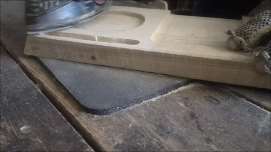

After that, I used a hand held sander to clean up the wood and make it nice and smooth.

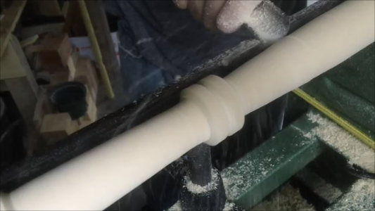

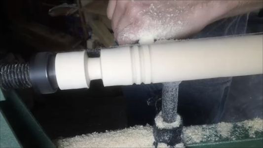

Step 2: Turning the Spindle

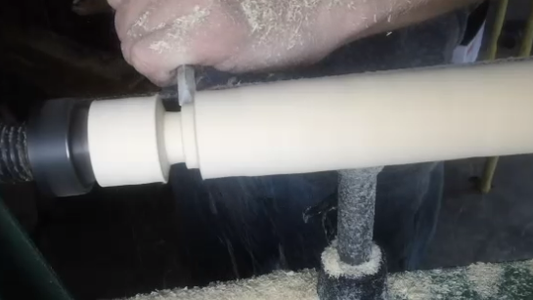

Having already drilled the 3/4 inch hole in the base, you need to make a 3/4 inch dowel at the end of the spindle to fit in there. I was extra careful to measure this several times just to make sure I didn't cut away too much, because a tight fit of these two parts is going to be crucial.
Other than that, you can make any design you like for the remainder of the piece. I kept it simply, with just a could of rings at the bottom and in the middle.
Next I turned another spindle to have at the top, for the headphones to actually rest on.

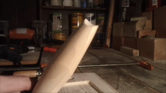

Once your two spindles are ready, drill a hole through the end of the one that will attach to the base. After that, you can saw the end off right through the middle of the hole. This gives a place for the second spindle to rest.

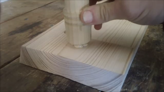

Just spread out some wood glue in that groove and clamp them together nice and tight. Then allow them to sit overnight.
The next day you can put some glue in the bottom of your hole, and all over the dowel and squeeze it in there. Make sure and arrange it however you want it to look. I wanted my headphones slightly hanging over my wallet, so I left it that way for the glue to dry.

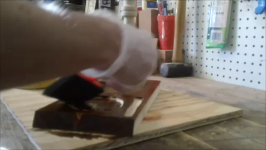

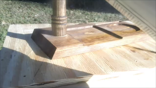

Then I stained the entire thing, gave it a few minutes then wiped up the stain with a clean cloth. I followed that with three coats of spray on lacquer, to give it a slightly glossy finish.
That's all there is to it. Now your headphones can be safe and you won't have to worry about them getting chewed up by your dog.
