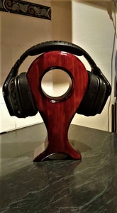

Introduction: Headphone Stand
After destroying yet another expensive gaming headset, by rolling over the wires with the computer chair, I thought it was time to make a stand for the new ones.

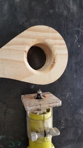

Step 5: Router the Edges
And used a router to remove all the edges to give it a nicer look. And finally I sanded my project smooth and stain with dark Mahogany stain and gave it 3 coats of gloss varnish. Time for total project was 3 hours excluding drying times.
