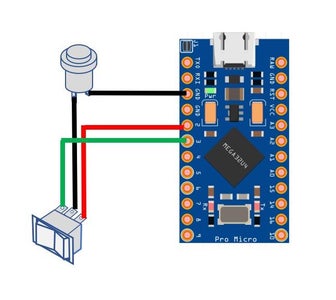

Step 6: Wire the Buttons
Wire the Arduino and switches as shown in the diagram. The rocker switch is used to connect either pin 2 or 3 to the Arduino via the momentary button. Zoom and Teams use different keyboard short cuts for muting the microphone therefore one pin is used for Zoom and one pin for Teams

Upload the programme attached to the Arduino (or copy and paste the programme below into the Arduino programmer). The programme can be altered for other programs that use different keyboard short cuts, just change the Keyboard.press(KEY_LEFT_xxxx); command in the Arduino programme.
