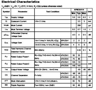

Now starts the real research work. We have to identify which chip is used for the audio amplifier, to find the technical data (the datasheet), and to track all connections. In this case it is easy to see that the chip is from the type APA3541 (product of ANPEC - http://www.anpec.com.tw ). Using the "Google" the datasheet can be found very easy. The APA3541/4 is an integrated class AB stereo headphone driver contained in an SO-8 or a DIP-8 plastic package with Mute feature . For us the most interesting information, found in the datasheet is : 1)the block diagram with the function pin description ;2) the typical supply voltage -for this case it is 5V ; 3) the possible driven load (can be 16 Ohm).
The task is now to connect the amplifier in the correct way.
I removed the flat cable. I plotted the picture of the PCB with the metal tracks view on a A3 sheet - to be easy to follow each track and connection. You can use markers with different color for each signal.
Let's start with the ground pin - normally the ground is the "fattest" wire on the PCB. It is chip pin #4.Using Ohmmeter you can check this. A suitable place where the ground cable ( "-" of the battery) shall be soldered must be found. There the green lack must removed from the PCB. I scratch it using a big needle. A hole for the ground cable must be drilled there.

Next step is to guarantee the proper power supply of the chip. We found that the chip must be supplied by 5V source. Such kind of batteries are not often seen. It is better to use a voltage regulator , which will produce the needed voltage. The most suitable, I found to be a regulator from the type 78L05 - it has 3 pins and small package. Practically it doesn't need an external components. To mount it on the PCB we need to scratch the green lack again in the proper places and to drill 3 holes for its pins.
