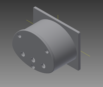

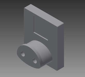

Step 3: Building the 3D Model
The holder itself has few functions. It should easily, comfortably hold the headphones, and the electronics. For the headphones, I measured the width and height of the headband when the headphones were at their smallest (earpieces fully retracted), and used that to make an ellipse for the headband to hang on.
The unit went through a couple of design iterations before I hit the final. Here I show the first and the last.
The first unit was quite large, because the plan was to have iconography with the unit, since all units would be made of laser cut wood. The large holes in the front were for wooden pegs to secure the unit together. I also wasn't really sure where I'd be storing the circuitry at that time, and was initially thinking of just letting the MP3 Player be its own audio interface.
There were multiple problems with this.
- The MP3 player buttons weren't real easy to use.
- The holder was going to be attached to the machine that's recordings it was playing. Iconography seemed redundant.
- The show was going to involve MANY artists, and I wanted the audio to be front and center for my piece, not the holder. The holder should be the minimal functional piece.
The redesign took this into account. Instead of iconography, I decided the material of the holder itself should reflect the recording, so I ended up making each holder on the machine it was playing recordings of. Hollowing out the center means I can store the electronics inside the player, and have the minimal number of buttons available for the user interface. I moved the securing holes outward, instead going with 1/4" holes which could be tapped for 1/4"-20 screws. While not reflected in the model, I also made simple iconography to go above the buttons for signifying which did what.
The final model consists of 3 pieces:
- The front plate, which holds the buttons and icons, with a slight lip at the top to keep the headphones secured.
- The middle piece, which is a hollowed out sort-of ellipse. It has a notch near the backplate for running power and headphone wires out.
- The back plate, which will be secured to a surface of the machine in the show.. I put countersinks on the back of the model to account for nuts holding screws on, though these were not always as large as they needed to be.
This meant that I could also easily rebuild pieces if there were issues, without having to rebuild the whole thing.
