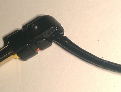

Step 1: Determine Source of Short
This particular pair of in-ear headphones had a short in the right ear. Given the initial cost and decent sound quality, it was definitely cheaper to repair the jack than to purchase a new pair.
You will need to determine the source of the short before cutting off the headphone jack. The short in this pair was very close to the jack itself.
In other cases, the short could be further up the wire closer to the earphone. You want to make sure that you find the short, and cut above that. You don't want to go through all the trouble just to have the short follow your work.
Begin carefully snipping away at the strain relief. I also removed the outer cover to the jack.

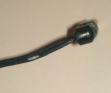

Step 2: Prepare Your Wires
Now for the hard part. The wires in the cable are very very tiny and very easy to cut with a razor blade. I would not suggest using any wire strippers for this.
One safe way to remove the outer [plastic] insulation is to place the razor blade on top of the insulation and gently roll the wire underneath. You will cut around the rubber insulation so that you can simply pull it off and get to your wires. If you place too much pressure, you will cut through the wires inside.

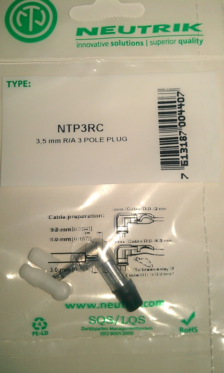

Now you will need to feed the wire through the barrel of the NTP3RC BEFORE you start soldering. This barrel will screw down over the other components of jack. The rubber end faces the headphones and the silver piece faces the exposed wires. The image is incorrect, however I added a note informing you of the correct orientation.

Step 4: Assemble Jack
Assembly is fairly simple, though the plastic strain relief took a little thought to figure out.
Once you have the strain relief in place, take the two silver pieces and place them over the jack. The wire will extend from the threaded ends.
The packaging has a diagram of how to assemble, but the Neutrik website also has a PDF which shows this step in a little more detail.
