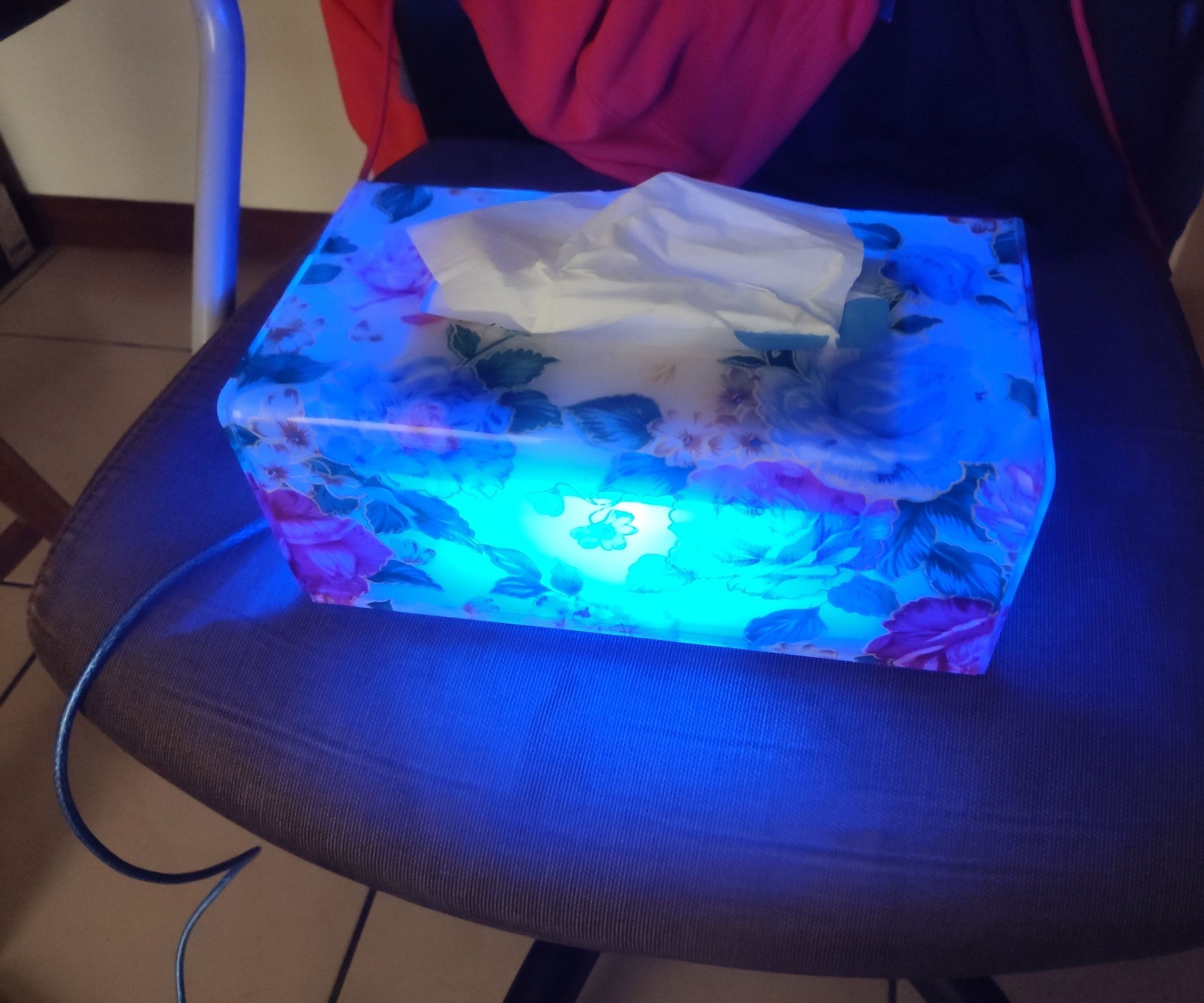

Step 3: Final
Take the cardboard and stick them together to any shape you want as long as you are able to put your board into and doesn't affect the ultrasonic distance sensor works. After that, you FINISHED the device, CONGRATS!!!!
