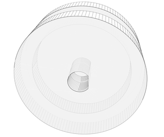

Print the wheel and put the washer "tire" into the slot.
