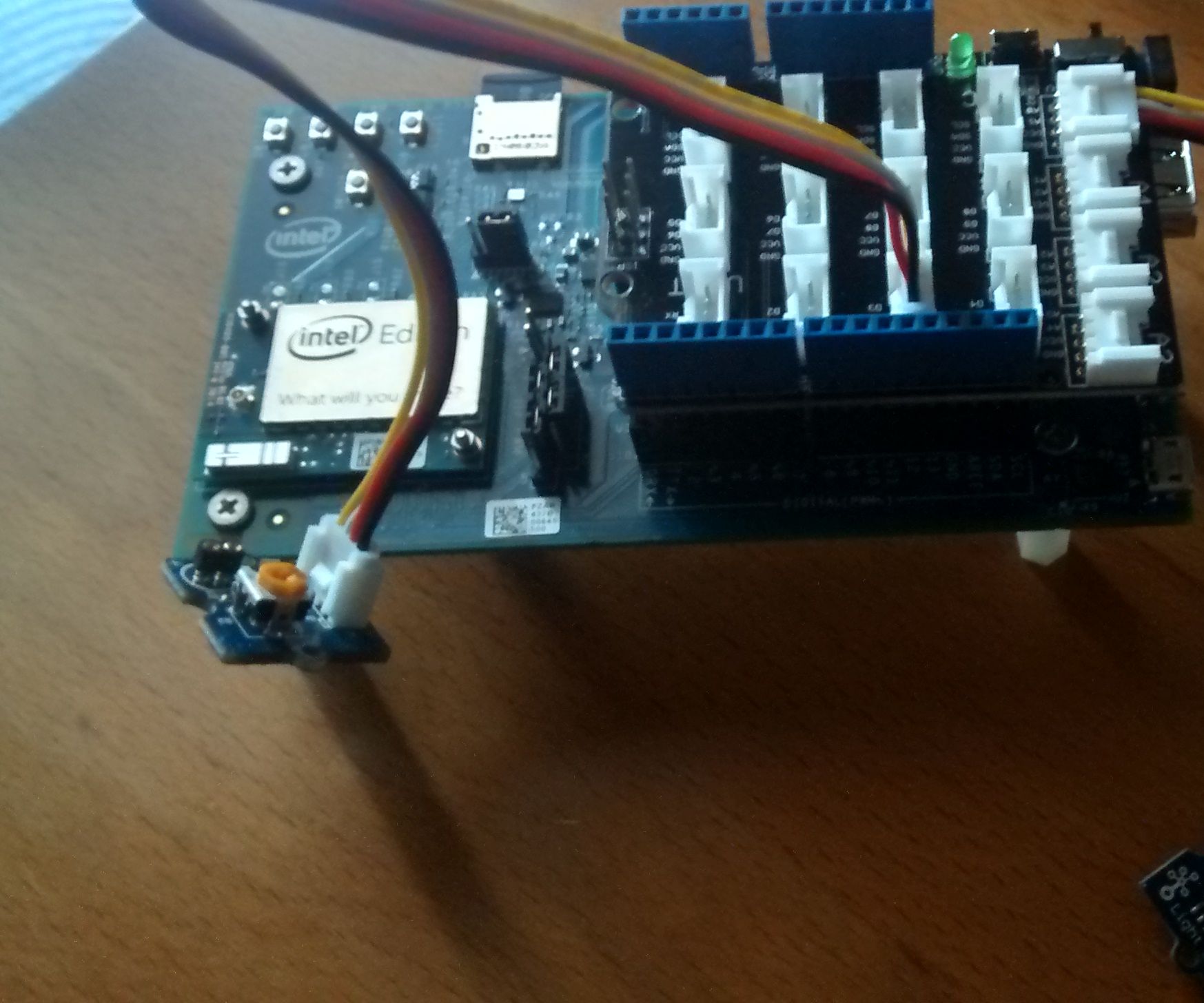

Step 2: Connecting It All Together!
Before we get stuck in I am assuming you have your Edison board set up as in Intel guide; if not you can view it here.
Before connecting it all up, I suggest you disconnect the power from the board, it helps prevent any short circuits and other issues.
Firstly, you must connect the Grove Base Shield on Intel Edison Board.
Then, the light sensor needs to connect to port A0 on the expansion board.
The Temp Sensor needs to connect to port A1 on the expansion board.
The Led Socket needs to connect to D3 on the expansion board with a LED (I recommend white).
The GMS Shield send and receive commands over the RX/TX pins.
