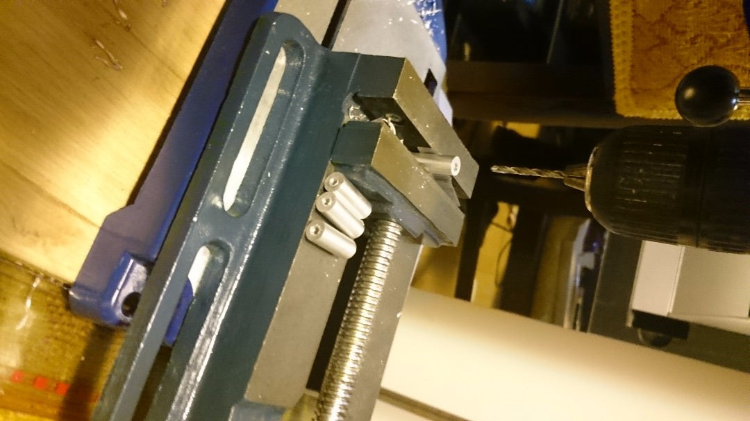

Step 2: How to Make the Support Board
The support board will hold all the components together and gives a brilliant design to the project.
With a drilling machine, abrasive tape and some basic tools, design the support board from plexiglas as you want.
After designing the support board, fix the components with screws on it.

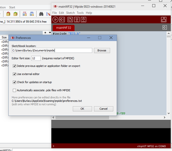

Step 6: How to Upload the Program
- Download MPIDE from chipkit website and install it.
- Download and unzip the program attached below.
- Connect the chipKit WF32 board to a computer using a mini USB cable.
- From MPIDE tools menu select the board type and the serial port used by the board.
- From MPIDE File->Preferences->Sketchbook location, select the mpide directory from the downloaded archive.
- From MPIDE open the main program file located at: your downloaded archive->mpide->libraries->ECG->mainWF32->mainWF32.pde
- Using the upload button, download the program into the microcontroller
