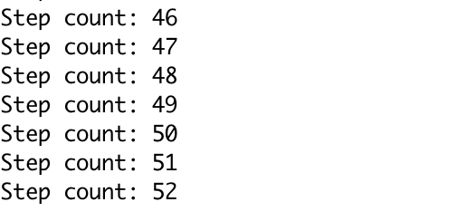

Step 3: Coding
The CurieIMU library has a built in calibrated and filtered value for detecting steps, so all we need to setup is the interrupt callback whenever a step is detected to count up by one. Also, the built-in LED on the Arduino's pin 13 is used to indicated whenever a step is detected by the Arduino 101 board.
Paste the following code to the ArduinoIDE and upload it to the Arduino 101 board through a standard printer cable (which came with the board). Once uploading is complete, unplug it.

Step 4: Run Forrest, Run!
- Strap the Arduino onto your wrist and plug in the barrel jack connector from the battery holder to the Arduino board to power it up. That's it, done!
Now, let's get some exercise. Run Forrest, Run!!! You'll be surprised how much (or how little) you walk on a daily basis!
