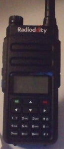

DMR however has a digital listing of call signs as they call in to the system through one of hundreds of repeaters around the world. This requires a DMR capable radio (such as the AnyTone D868UV or Radioddity GD77) programmed to listen to a local hotspot/repeater.
