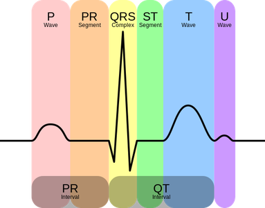

Step 1: What Is ECG
Electrocardiography (ECG or EKG) is the method of recording the electrical activity of heart over a period of time using the electrodes placed on the skin.

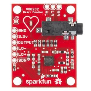

Step 2: Heart Monitor AD8232 Board
The simple and easy to use breakout board for heart rate monitoring from Sparkfun. This board measures electrical activity of heart through the Electrode pads placed on the skin. By Interfacing this board with Arduino we can get ECG graph through Processing IDE window.
Pin Configuration
connections :
GND Ground GND
3.3v 3.3v Power Supply3.3v
OUTPUT OutputSignal A0
LO- Leads-off Detect –11
LO+ Leads-off Detect +10
SDN Shutdown Not used
Electrode Pads Cable ColorSignal
BlackRA (Right Arm)
BlueLA (Left Arm)
RedRL (Right Leg)
