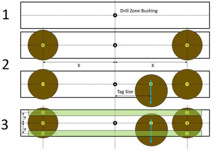

Step 1: How the Heart Tag Jig Works
The ends of two wooden beams are attached to edges of two rotating cam. As you rotate the cams inward, the beams act like sliding arms guiding (or hugging) a heart tag half forcing it to be perfectly centered widthwise. A third cam, near the bushing, ensures that the heart tag half is also aligned exactlylengthwise to its exact midpoint and over a centering bushing — the Drill Zone. This makes sure your drill hole lands exactly where the twist point needs to be.
Once the heart tag is aligned, you drill through the bushing. The hole ends up in exactly the right spot which ensures that when insert a pin and twist the two halves of the tag, they match up perfectly flat and symmetrical – smooth as silk for your fingers.
Step 2: Design & Build the Jig
Step 1: Build the Base
  1. Cut a rectangular base for the jig from plywood or MDF
  2. Mark the center of the base — this is where the drill bushing will go.
  3. Install a metal drill bushing in the center (length and width) of the base.
Step 2: Prepare the Rotating Cams
  1. Drill a center hole in two of the cams and mount them along the base center at equal distance from opposite sides of the Drill Zone. The distance between the cams does not really matter since the key part is to make sure the cams pivot points are on the base center line. (Tip: Make the cam distance (X) at least 4-5 times the length of your work piece.)
  2. Take the third, cam and screw it in place around the length of your piece from the drill zone bushing and along the base center line . This cam needs to be a bit offset so it can position the piece lengthwise every time.
Step 3: Install the Centering Beams
  1. Attach the wooden beams to each cam edge so that when the disk rotates, the beam swings inward toward the center. The beams need to be opposite and of equal distance from the center of the cams.
  2. This makes sure the beams will meet directly over the centering bushing when aligned.
Step 4: Test
  1. Test the jig to make sure the beams and center cam guide the heart tag to dead center by drilling a test block and seeing if the hole is exactly in the center of the piece (length and width).
  2. Don’t’ work if things are off a bit widthwise, you can fine tune the centering using tape layers. (I had to do that.)

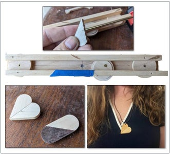

Step 3: Making Heart Tags
Now that your jig is ready, here’s how you use it:
  1. Place one "heart half" between the two wooden beams.
  2. Rotate the outer cams inward so the beams slide the piece perfectly centered over the base centerline.
  3. Now rotate the alignment cam so the tag center line matches the drill zone bushing. (Tip: Add a tick line on your tag so you can make this vertical alignment easier. Once the alignment cam is set then all further pieces will be set lengthwise.
  4. Hold or clamp in place the tag to ensure the piece remains tight on the base.
  5. Drill through the bushing using a drill bit slightly smaller in diameter to your metal pivot rod.
  6. Repeat with the second tag half.
  7. Press a small metal rod (I used a tig welding rod) into one of the heart tag pivot holes. No glue needed since it's a tight pressure fit.
  8. Now take the other heart tag half and press that firmly into the other half.
  9. Twist the two halves — and voila! A perfect, symmetrical heart. (If you are off a bit, no worries, you can adjust with tape on the jig or do a little sanding to get to the smooth alignment you want but this jig gets things very, very close if made right.)

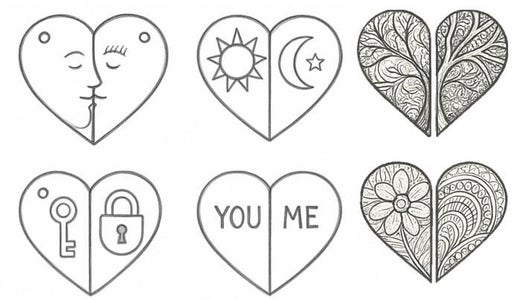

Step 5: Best Is You Can Customize Your Heart Tags
One of the most magical parts of the Heart Tag design is the opportunity to create a message, image, or emotion inside the twist. Because the heart is made of two flat, capsule-shaped halves, any design or drawing you place on them appears abstract or even meaningless — until the pieces are twisted into the heart shape.
The surprise happens when the full image is revealed.

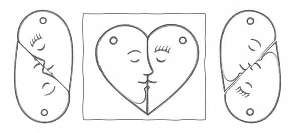

One of My Favorite Designs
For example, on one half of the tag, I sketched of a man, looking to the right with a smile. On the other half, I drew a woman facing left, smiling back at him. When laid flat, it looks like some strange pattern — almost like a Rorschach inkblot.
But once twisted into the heart shape, their eyes meet. Their smiles align. Suddenly, it becomes a shared moment only appearing when the parts are twisted.
This ability to **embed a story or message** adds emotional depth and turns each Heart Tag into something truly personal.

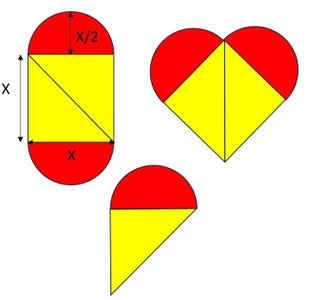

Note: this Ible was mainly about the jig here's a short video showing how I cut the heart tag halves using a CNC. As you’ll see, the cuts are very precise — which is exactly why I needed a jig that could match that precision when drilling. If the drill hole is even slightly off, the twisted heart won’t align flat.
Also included is a simple pattern to make a perfect heart.
