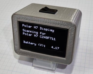

In addition to verifying that your workbench is working, you need to use the scanner to find the device name for the heart monitor you want to connect to. Put on your heart monitor and run the scanner. You should find an entry that looks like this:
Discovered a peripheral
Address: 00:22:d0:8c:50:50
Local Name: Polar H7 8C505015
Service UUIDs: 180d
RSSI: -55
The Local Name entry will be coded into the program to identify the device you want to connect with. See line 94 in the program.

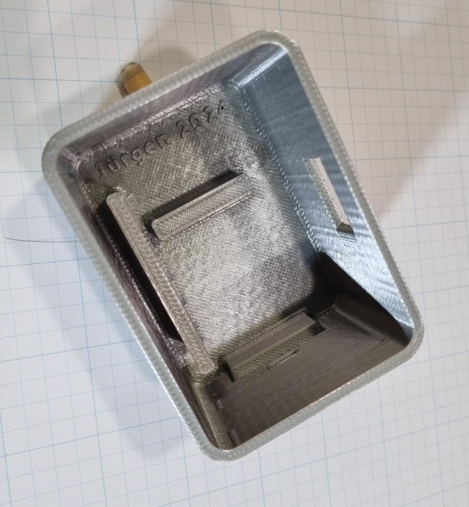

The picture above shows all the parts nestled inside the 3D-printed enclosure. Not clearly visible is the small piece of clear plastic 3D printer filament which acts as a light pipe to channel the light from the charging LED on the board to a spot next to the power plug. This turns off when the battery is fully charged. The board's USB connection is accessible through the side of the case for charging and/or reprogramming.
Two dimensions of the case design are dictated by the size of the display. The third dimension is driven by the battery. I wanted to lay it flat on the floor of the case for stability, and to avoid blocking the antenna that's on the circuit board.

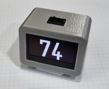

Step 5: Ta Da...
All done. When the monitor turns on it shows which Polar sensor it's looking for and shows the current battery voltage. When the sensor is worn, the heart rate is displayed and can be seen easily across the room. I've tested the distance to 45 feet, which is larger than my exercise space.
I've tested this with several ESP32 boards - check the code listing for details. That I can easily move this project among different boards is a testament to the flexibility and robustness of the Arduino hardware and software environment. I did notice something interesting... The time to compile and load the project onto a different board can vary, a lot. The more complex the processor, the more translations and libraries need to be brought in.
