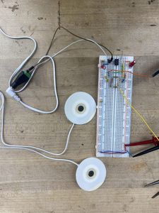

Step 1: Build the Circuit
Build the circuit according to the schematic. Break down the circuit into three stages and individually unit test
  1. Sensor: ECG pads > TENs leads > screw terminal > jumper cables
  2. Use a multimeter to check continuity between the pads and the jumper cables

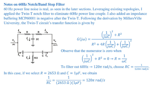

  3. Signal conditioning: connect the instrumental amplifier and passive twin T filter to reduce power line noise
  4. Use a voltage regulator to apply a 0.01V DC on the input pins of the AD623 to test the gain of 1000 at the output pins. Be careful not apply a large input voltage, otherwise you may cook chip!
  5. Output: 10x oscilloscope probe
  6. Connect the leads according to the image above.
The twin T filter is tuned to filter out 60Hz powerline noise. This frequency may be different depending on the power grid of your municipality!
