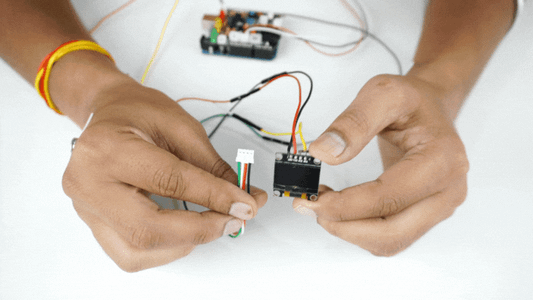

Step 7: Connect OLED Display
Connect the OLED Display to any one of the I2C ports of Muscle BioAmp Shield using the 4 pin STEMMA cable as per the following:
VCC to VCC
GND to GND
SCL to SCL
SDA to SDA
