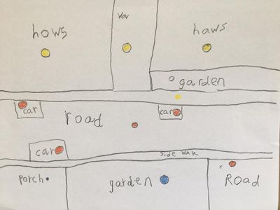

Explain that teams should start by drawing a sketch map of the area they will be surveying. The maps do not have to be very accurate but should show major features such as buildings, gardens, trees, roads, etc. Students can always add detail as they go.
If students already have a lot of theories about what areas are likely to be hot or cool, you can have them make predictions about what areas would be warmest, coolest, or in the middle. They should record their predictions on their map with dots of color (red=warmest, yellow/orange=medium, blue/green=coolest).

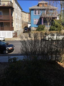

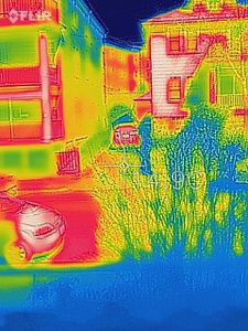

Once students have drawn their map, have them measure and record the temperature of all the surfaces they can safely reach in the area. For now, they should write the temperatures on their map (later they can go in and decide on ranges and colors). The activity will be most compelling on a warm, sunny day.
Students will quickly find what areas are similar or different in temperature. Participants in this activity have been surprised by how moving a few feet in one direction can make a big difference: for example a surface in the sun versus in the shade of a tree. Likewise, students have been surprised at just how hot some surfaces can become -- for example the black roof of a garden shed. The color of objects can make an unexpected difference too, for example, two cars may have very different temperatures, as can two types of pavement. Also, the direction surfaces are facing will have an impact.
The coolest areas are likely to be areas with plants and trees. This is both because of shading from the trees, and evaporative cooling (see Tree Sweat, Bottle Sweat: Evaporative Cooling).

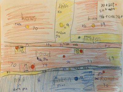

Once students have recorded the temperatures, have the groups color their maps. You can get into interesting discussions about what range of temperatures should count as cool, medium, or hot.
Students may find additional variables to consider, for example, the maker of one of the maps above added notes about the color of each surface -- triggered by the discovery that the black and white cars had very different temperatures.
