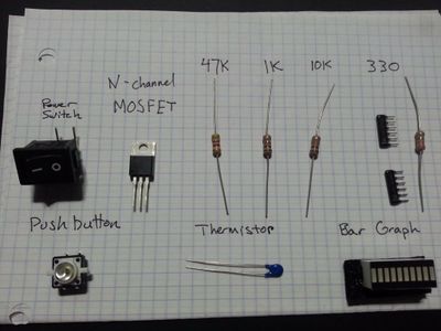

Step 1: Parts List, Things You'll Need
Processor: Arduino Pro Mini 5V (You can also use the Uno if you can live with the form factor)
N-Channel MOSFET
Thermistors (any type)
Bar Graph LED display
Pushbutton (I use one with an LED backlight)
Power Switch
Schottky Diode (not pictured)
Resistors (330K, 1K, 10K, 47K)
Resistor array bars (2x 330K)
Protoboards (x4)
Aluminum plates 2mm thick
1/2" Aluminum Corner Channel
Screws (#4 and #2), nuts (#2) and rivets
Jumper wires
Banana plugs and terminals
Fans
12V Power Supply

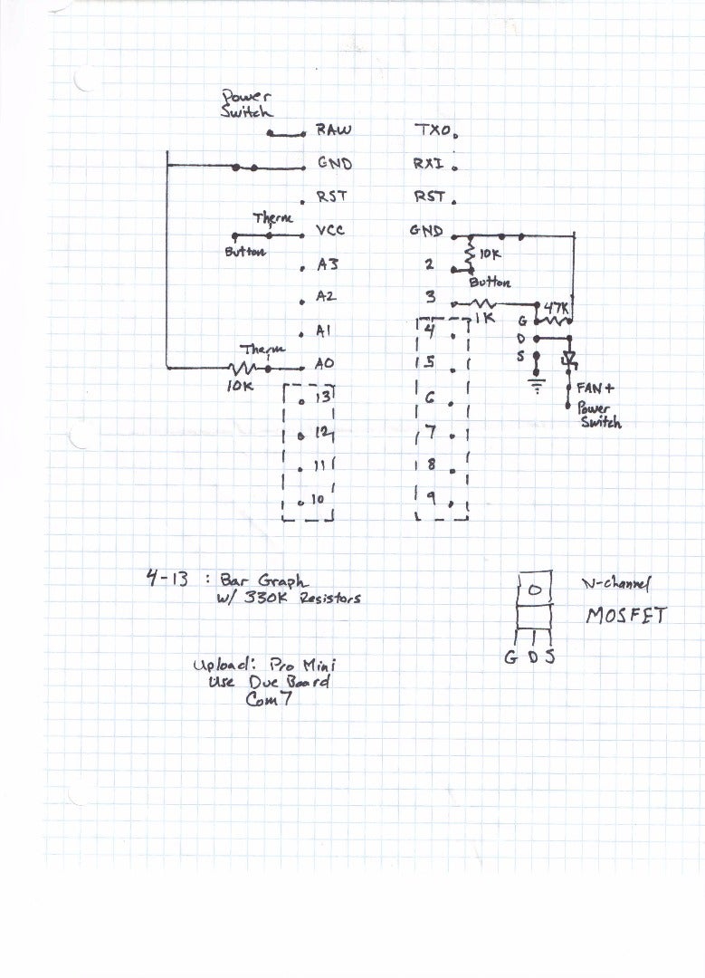

Pictured is the schematic of the little protoboard used for the processor. It's fairly simple. The center two rows are the Arduino Pro. I soldered male header pins (extended a bit) to the arduino and then pushed them through the back of the board and soldered to the board. As you can see in the picture, I used 90 degree male headers on the programming side of the board. Make sure to mount the board with the 90 degree headers facing the top of the enclosure. Then, if the board needs to be modified after installation, you can simply pop the top and connect the programmer to it.
Keep in mind, the schematic isn't exactly to scale, but the protoboard is only about 2" square. "Therm" labels are the thermistor. G D S is the gain, source and drain for the MOSFET. Digital pins 4-13 simply jumper to a separate board I mounted the LED bar graph on.
The Arduino Pro is programmed with a simple code to monitor the temperature probes continuously in the main loop. The button for the temperature tweak is set up on the interrupt on digital pin 2. The "analog" output, set up on digital pin 3, is really digital pulse width modulation on one of the Arduino's PWM pins and generally takes a value of 0-254. There are a bunch of ways to convert the temperature values to PWM output levels. At first I tried mapping the temp values to a 0-254 range. This produced a smooth transition of values, but I didn't really want a smooth transition, so I abandoned that approach for a distinct 5-tiered level. Each level is activated when a temperature threshold is reached. This is done by a simple comparison operator control structure.

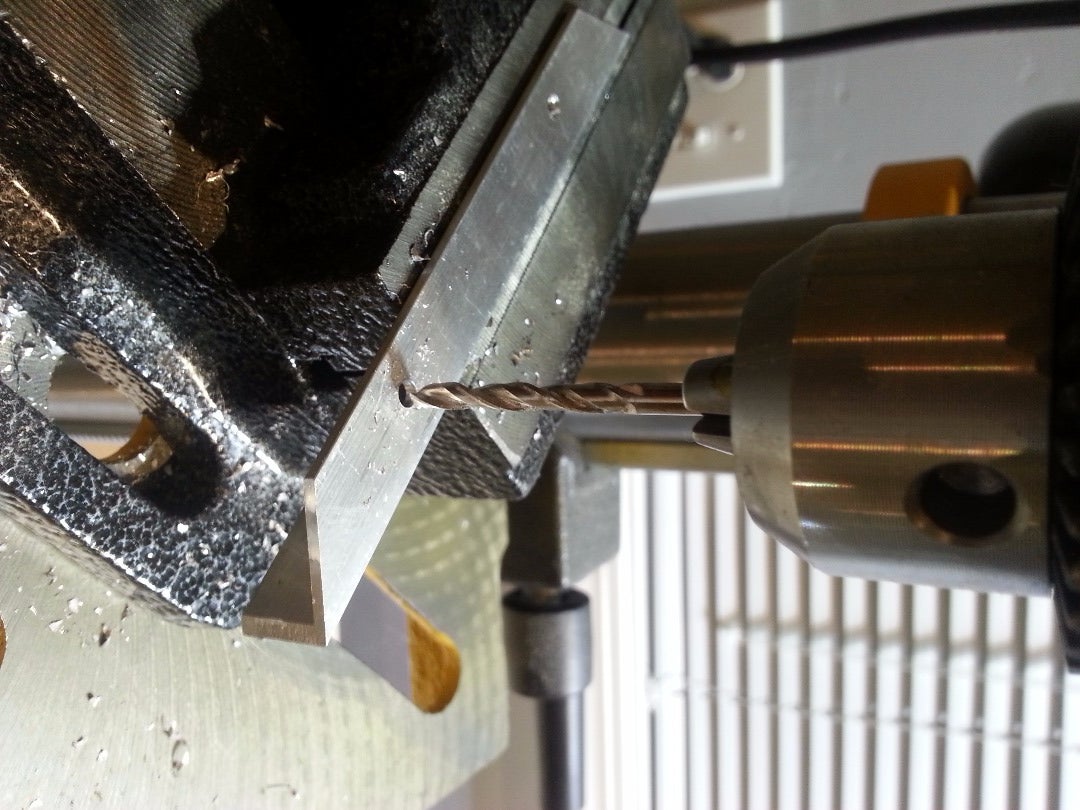

First I planned the size of the enclosure. I didn't want it too big, but it's always good to have extra room for wires. With the protoboards finished, it is easier to see how much room you need. Then miter the trim for the top and bottom pieces. I used a chop saw with a ferrous metal blade for this because it gave the cleanest and most accurate cuts.The top and bottom are removable for access. Drill holes big enough for the rivets along one side and holes the right size for the #4 screws to pass through on the side which will be the edge.

Next cut the flat panels for the sides, top and bottom. The panels are small and don't need dead-on straightness because of the trim, so I used a band saw and free-handed the cuts. Rivet the edges to the top and bottom panels. I would suggest marking everything on the inside so you can keep things "straight", right? I brushed each of the pieces as I went to give it a better finish. To connect the side panels, drill and tap the panels to accept the #4 screws, as seen above.

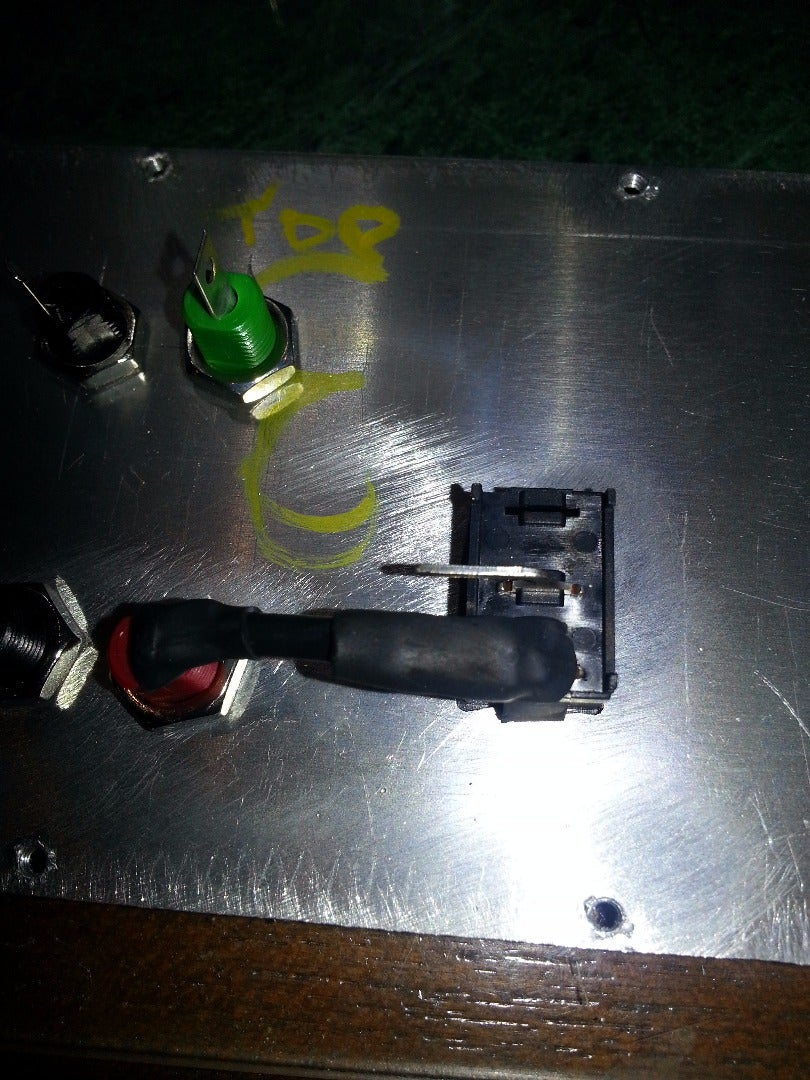

Map out where you want the terminals and switches. The button and bar graph are clearly on the front panel for visibility and access. Placement of the rest goes wherever practical. I drilled some holes with the enclosure intact and disassembled it for wiring and connections. Some of the boards required spacers to keep them off of the sides of the enclosure. Be careful to avoid any short circuits (aluminum is a great conductor!). In the picture of the main board, you can also see a chunk of left over aluminum I screwed to the MOSFET to act as a heat sink, although it doesn't really get very hot. Use a punch to set where you want to drill the smaller holes. I used #2 screws and nuts for the boards. Put a little thread-lock on the to keep them from backing out.
Step 7: Cutting Square Holes
Cutting square holes is a real pain, but is necessary for some of the components. It is needed for a good finished look on the bar graph, the fan terminals and the power switch. drill a series of small holes and then hammer it out. When I hammered it out, it started to warp the aluminum which is pretty thin, so I used a dremel to carve the little holes out a little which made the hammering a lot easier and quicker. The edge will be very jagged and must be smoothed out with a hand file. It's a good workout, but worth it.
