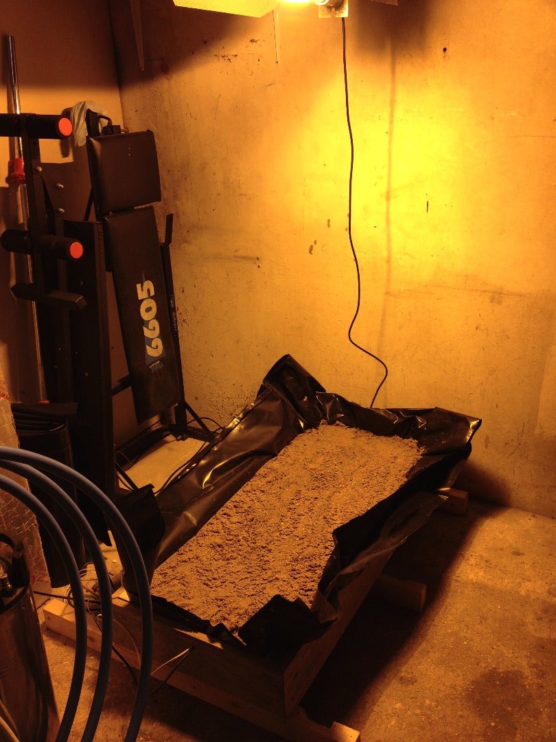

Step 4: Add the First Layer of Sand
Fill the box with a layer of sand about 50mm/2" deep.

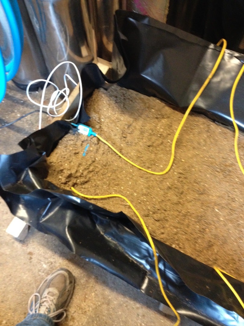

Step 5: Lay the Soil Warming Cable
As you work your way around, place some damp sand on top of the cable to keep it in place while you're working. Also, my cable recommended being switched on for 5 minutes or so before use, in order for it to be more pliable.
Lay the controller's external sensor cable, placing the sensor in the centre of the bed.
Step 6: Final Layer of Sand
Place another 50mm/2" layer of sand over the cable being careful not to disturb it.

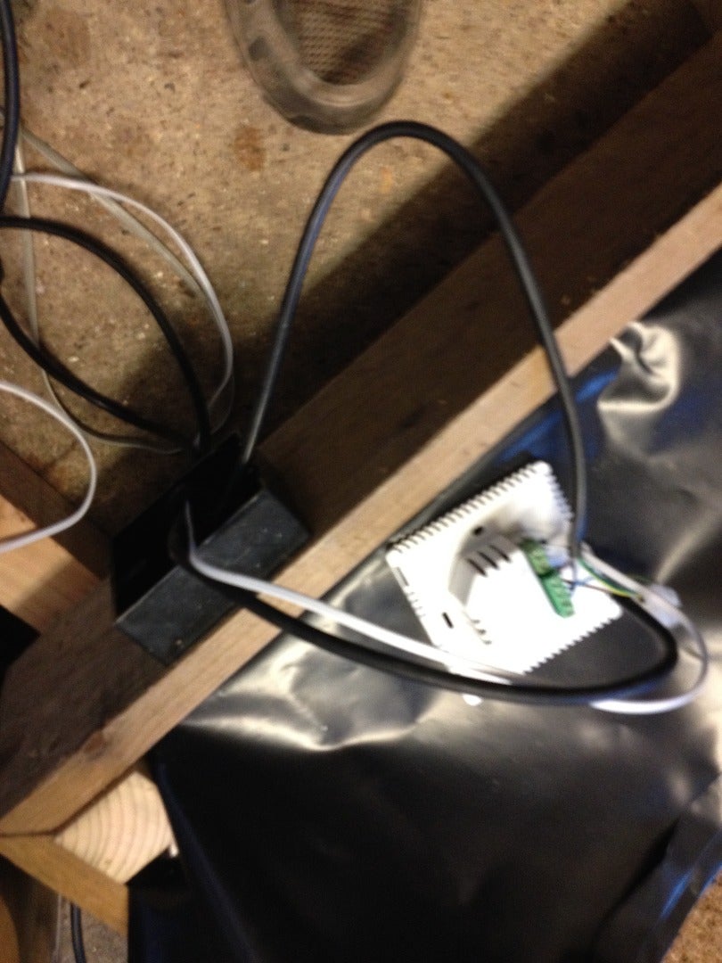

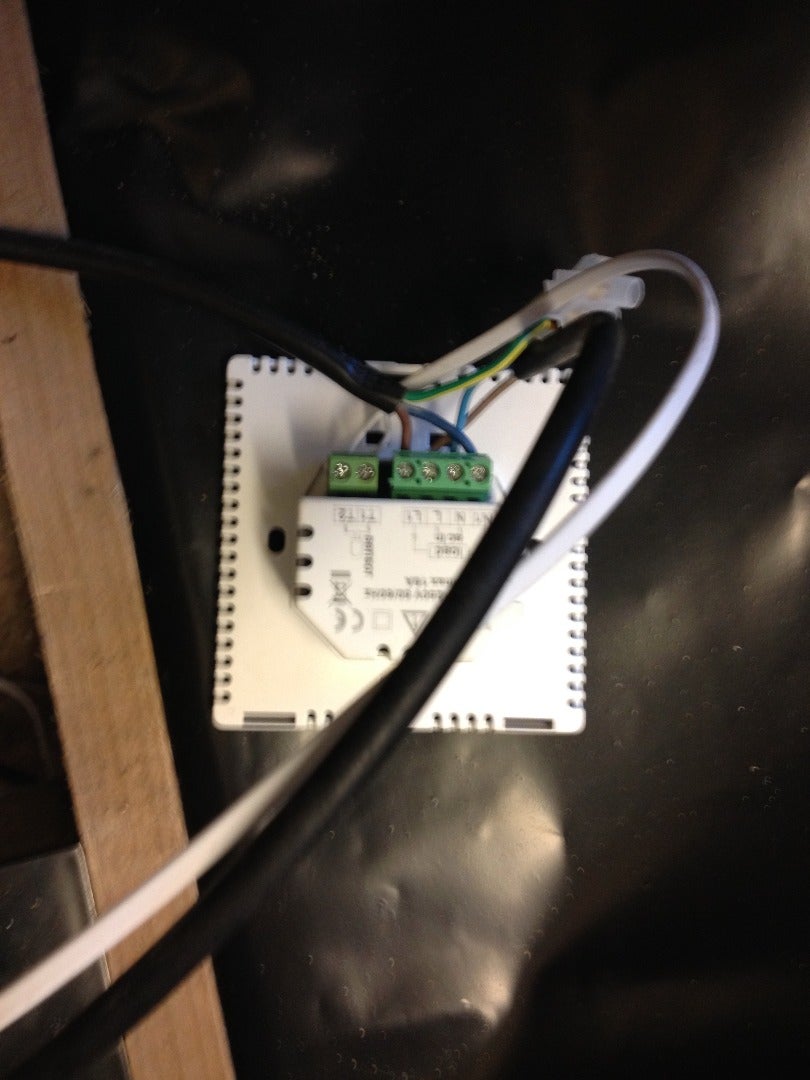

Step 7: Wire Up the Controller
  • attach a mains socket back box to the wooden box
  • remove the mains plug from the soil warming cable and prepare the conductors
  • following the guidance from the controller manufacturer, attach the warming cable to where the controller has 'load' marked
  • attach mains cable to terminals on controller, again following the manufacturer's guidance, mine was marked L N E
  • attach the external sensor to the correct terminals
  • pulling the wires gently through the grommet, push the controller face in to the socket back and screw in place.
