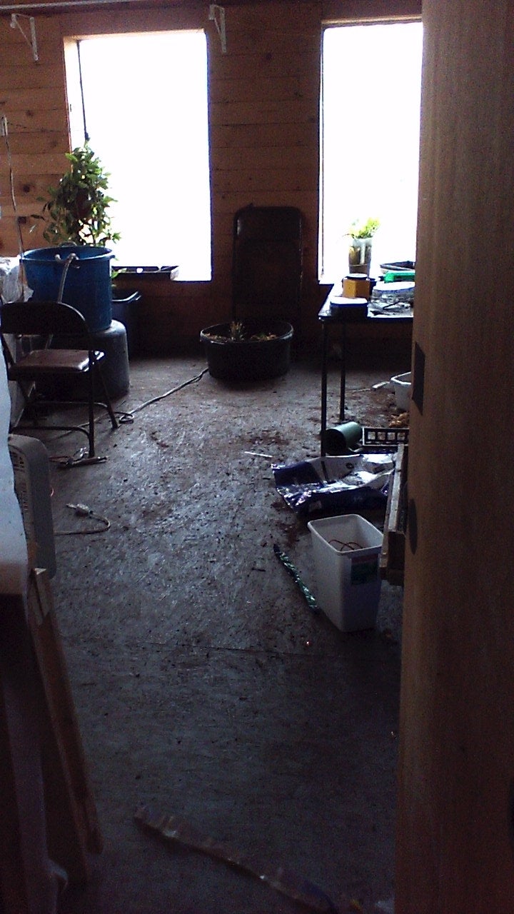

- I had a big mess up there from last year so had to clean it up
- Lay the horses out, Then put the braces on
