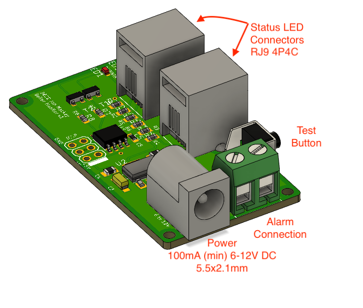

As noted, this project relies on the fact that many boiler controllers have terminals to attach an alarm. These two terminals on most controllers are the isolated dry contacts of a relay. When running normally the contacts are open. When an error occurs the contacts close.
There are lots of ways of creating a status indicator with two LEDs that behave as described in the introduction (555 timer, etc.). I decided to use an ATtiny13A mcu.
The ATtiny13A can be configured to use an internal pull up resistor on any of its 6 I/O pins. As noted, the normal state on the boiler controller alarm terminals is open. One of the alarm terminals is monitored by the ATtiny13A pin with the internal pull up resistor. The other alarm terminal is connected to the board’s ground plane. In addition to being able to pull up a pin you can also configure a pin change interrupt. The interrupt handler is called whenever the state of the pin (or pins) change. The normal state of the pin is high due to the internal pull up resistor. When a boiler error occurs, the contacts close and the ATtiny13A pin is connected to ground causing the interrupt handler to be called. When the boiler error is cleared the interrupt handler is called again when the pin returns to its normal high state.
You may ask, why use an interrupt handler when you could just as easily monitor the pin state in the sketch loop? In this case it really doesn’t matter, I just decided to use an interrupt handler. If you had to monitor several pins, the value of an interrupt handler becomes obvious.
The LEDs are controlled via N-channel MOSFETs indirectly off of two of the ATtiny13A I/O pins. MOSFETs are cheap and they also ensure that no more than the maximum 40mA current per ATtiny13A I/O pin is reached, as well as the overall ATtiny13A maximum of 200mA. You could eliminate the MOSFETs if you know that whatever is being driven by the MOSFETs is less than the I/O pin maximum. If you want to use MOSFETs on a prototype board with a TO-92 package, you can substitute 2N7000 for the SMD BSS138 specified in the schematic.

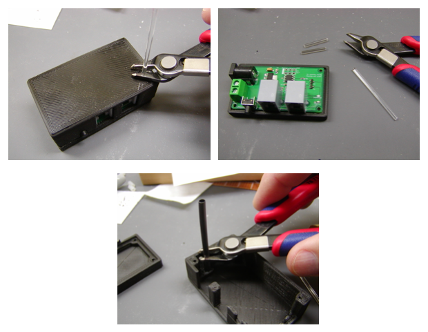

There are two LEDs on the board for testing. When the board is mounted in its case the case needs to be fitted with two 2mm clear acrylic light guides. (source)
Note: The 2mm rods I purchased were slightly oversize. I had to use a 2.2mm drill bit to ream the holes.
Temporarily place the monitor board within the case. Insert a length of acrylic rod in one of the 2mm holes above the LEDs till it contacts the LED. Using a flush cutter, cut the acrylic rod. Do the same for the remaining LED hole. With fine sand paper mounted on a block, sand the ends of the rods flat. Remove the board from the case. Using a scrap piece of 3D printer filament, mix up a small amount of clear epoxy. Use the printer filament to dab a small amount of epoxy in each LED hole. From the inside of the case, insert the prepared rods till they are flush with the top of the case. Carefully wipe off any epoxy on the case surface. Put the case aside till the epoxy cures.
Assembly LED
Once the epoxy cures, cut pieces of heat shrink tubing to mask the surface of the rods within the case, only exposing the ends that face the LED. Shrink the tubing.

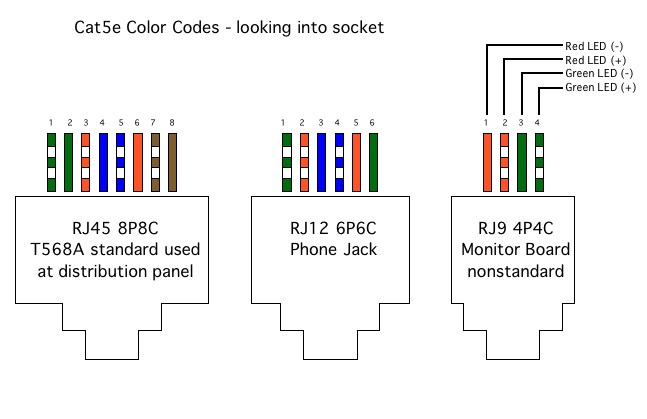

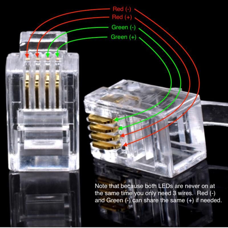

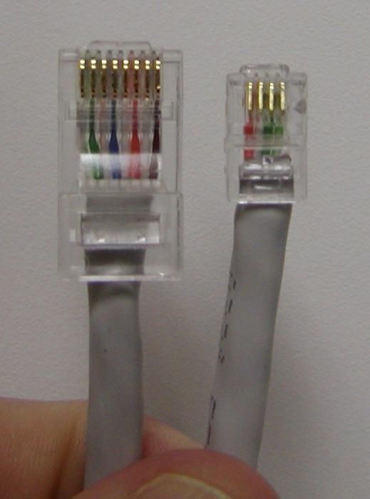

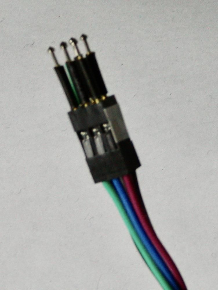

As noted in the introduction, this project repurposes one or more phone jacks as status indicators. In my case the jacks are installed within US standard 1-Gang electrical boxes. I chose not to remove the original 6P4C RJ12 connector (see last picture in step.) I created an adapter using an RJ12 6P6C plug with a short piece of Cat5 wire. As noted in the photo below, you need a minimum of 3 wires, preferably 4.
4P4C
Locate the wire serving the phone jack to be repurposed and disconnect it from the telephone network interface.
Note about US phone jack wiring:
When wired correctly these lines are “home run”, meaning a wire for each jack runs back to a common location in a star pattern. In incorrectly wired homes some or all of the jacks are daisy chained together. Hopefully you had a qualified electrician or, if your house is old enough, it was wired by the phone company. Older homes in the US will generally have several 3 or 4 wire cables all converging on the network interface located in your basement or mounted on the outside of the house.
You can use whatever color code you desire. Because my house has a distribution panel in the basement with an RJ45 connector for each phone line it was easy to disconnect the phone line by removing its patch cable. I then made a custom patch cable from RJ45 to a RJ9 connector on the boiler monitor board using a short length of Cat5. The diagram below shows the three connector types used at my house and the color codes.
Color Codes

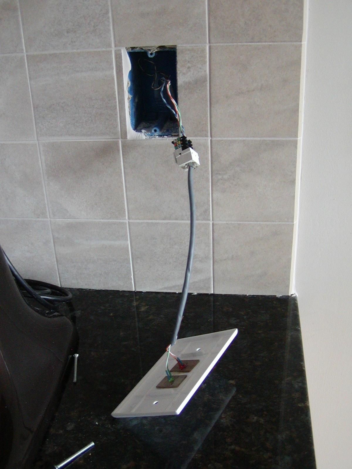

If your phone jack is mounted in a 1-Gang box as shown below, you can mount the LEDs on a blank box cover using epoxy. Because the blank cover isn’t very thick, I used two thin pieces of wood to serve as a spacer so that the LEDs don’t extend too far on the cover face.
Status Panel Wiring
I suppose if you don’t want to change the box wiring at all, you could make something that you plug into the existing RJ11/RJ12 jack and mount it to the existing cover with velcro or double stick tape. Note that doing this is a bit risky. If someone plugs this into a live phone connection one or more of the LEDs will burn out. If you look at the color code I used, I avoided the blue/white blue pair because on a live phone line these are energized to around 48V. Depending on the age of the phone lines in your house any of the wires may be energized.
