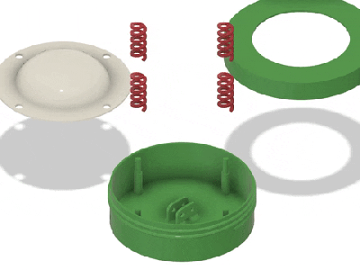

Step 2: Print 3D Parts
The four parts were printed in the orientation shown in the pictures. The layer height was 0.25 mm for the Button, Base and Lid (20% infill). For each of the 4 springs, layer height was 0.18 mm (100% infill). I did not use any supports. The spring was designed with an extra closed ring at the bottom to facilitate adhesion to the print bed. However, if you have adhesion problems, you may need to add a brim or raft. That's not a problem because the springs were designed longer than needed and the bottom part of the coil will be removed later using a wire cutter (Step 5).
Natural translucent PLA or clear T-Glase was used to allow illumination of the button’s dome. Any color PLA (or PETG) is fine for the remaining parts. Aside from removing stray strings from the holes on the lid (including the hole in the middle on the bottom) and sanding/filing rough edges, very little post-processing of the button, base or lid was needed.
I decided to try 3D printing the springs after failing to find wire springs of the right sizein local hardware stores. To be honest, I was surprised that I was able to design plastic springs that worked as well as they do. If you have better luck finding appropriate wire springs locally (or online), you can easily substitute them for the plastic springs.
Design Notes: The four vertical shafts around the perimeter of the base are two-tiered to prevent the button piece from bending the roller arm on the microswitch. The ledge on the lower tier allows the button to go down far enough to close the switch, but no further. The screw-top lid makes assembly and access to the inside easy for anyone who's ever used a mason jar. If that turns out to be too easy for your users, you can always drill a hole through the side of the assembled lid and base and insert a screw to make disassembly more difficult.
Fusion 360 Design Files: Separate design files are included for the spring and for the main button assembly. My steps to the final design were somewhat circuitous, so let me know if I left anything out.

Step 5: Final Pushbutton Assembly
The Fusion 360 animation shows how the printed parts fit together (detailed description below).
  1. Trim the springs: Use the wire cutters to remove the circular ring at the base of each spring. Continue to trim the ends until the height of each spring is about 30 mm. Slide the springs over the 4 vertical shafts. The top of each spring should be about 1-2 mm below the top of the shaft.
  2. Center the button dome on the base: Align the 4 holes on the button over the 4 vertical shafts in the base. Turn the button in a counterclockwise direction so the hanging LED wires are directed away from the lever arm.
  3. Screw lid onto the base: To maintain button hole alignment, keep the button pressed down on the springs until the lid is completely screwed on.

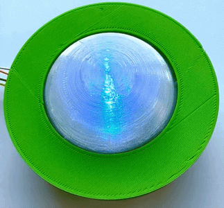

Step 7: Smash That Button!
If everything uploaded correctly, the button dome should be continually illuminated with a rainbow color sweep. Pushing the button should produce five white flashes before resuming the color sweep. Button presses are ignored during the white flashes. Click on the Serial Monitor icon in the upper right hand corner of the IDE window to view incoming pushbutton data. Right after releasing the button, the Serial Monitor will show the duration of the button press (in msec) and the total number of presses since the UNO was last powered up or reset.
The sketch is commented to explain what's going on in each section. To deal with the problem of switch bounce, the TimerOne Library was used to set up a clock interrupt function that checks the status of the switch input pin every 10 msec. The sketch will only count an input as a new button press if the switch was closed on the last 10-msec clock pulse, but is now open. Thus, to be counted, a switch closure must last at least 10 msec, which is longer than the typical duration of switch bounce. As you will see by running the sketch, most presses with this pushbutton are much longer than 10 msec (50+ msec). In other words, by using a 10-msec clock interrupt, you can avoid switch bounce problems and you need not worry about missing any button presses. Of course, this strategy necessarily imposes a slight delay (< 10 msec) between the precise moment of switch closure and the program's ability to act on that input, but that kind of precision is probably not an issue for most Maker projects.
The sketch illustrates some additional advantages of using a clock interrupt function. For example, by counting the number of clock interrupts between the onset and offset of the switch closure, the program can measure button press duration with 0.01 sec resolution. Also, the number of clock interrupts can be used to time output events like blinking the UNO's built-in LED every 250 msec and updating the rainbow color sweep every 10 msec. In this sketch, the clock interrupt makes it look like the UNO is doing 3 different things "simultaneously": (a) monitoring button presses, (b) blinking the built-in LED, and (c) displaying a rainbow color sweep on the button dome. It would be much more difficult to do all three things in the main loop function using the delay() function for timing.
