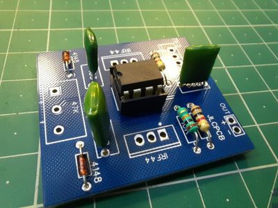

Step 3: PCB Designs:
I designed the PCB files using the schematics given above. Generate the Gerber files and order the designs from PCBWAY just in $5 for 5 pcs. If you want to use the same designs then download the Gerber files from here.
Everything is arranged in a very small form factor, still I am using pin headers for the input and output. But I will update the design soon which covers better arrangement of components (SMD) and atleast screw terminals for I/O section. I am using blue color, Hasl finish 1.6mm thickness FR4 for my project and to know more about the specs visit PCBWAY home page.
Step 4: Assembling and Soldering:
After getting the PCB files, I collected all the required components and start assembling. I always prefer to mount resistor and diodes first. Then go with the capacitors, IC, regulator, potentiometer and MOSFET. Mount a small heatsink on MOSFET for faster heat dissipation.

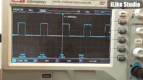

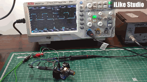

Step 5: Working:
The PWM waveforms can be seen on oscilloscope, and by turning the potentiometer we can change the duty cycle of the wave. Which then increase/ reduce the ON time on Mosfet and hence the overall output can be controlled. Always connect the PWM controller to a filtered linear power supply unit or SMPS. Noise may cause PWM fluctuations and output can be disrupted.

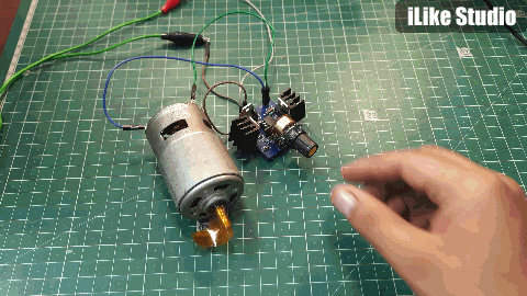

There is one mistake in design, the potentiometer work in opposite direction. But the circuit is okay and working well. Here I also performed a test using DC775 motor. The overall duty cycle can be changed to 0 to 100%.
