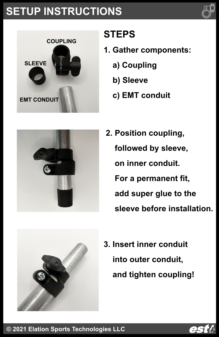

Step 2: Assemble the Telescoping Portion
These EMT conduit telescoping clamps make it easy to create a telescoping pole out of EMT conduit! They're made of injection-molded UV-resistant and durable plastic which is suitable for outdoor use, and they clamp onto the outside of the conduit - no drilling required!
Add one pole clip to the top piece of 1/2" EMT conduit using a Phillips head screwdriver. These will serve as the anchor points for your sun shade.
