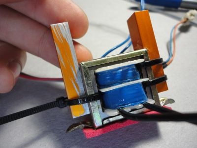

At last, the transformer will be fixed to the bottom plate of the keg, so I marked there to drill using the part itself as template.

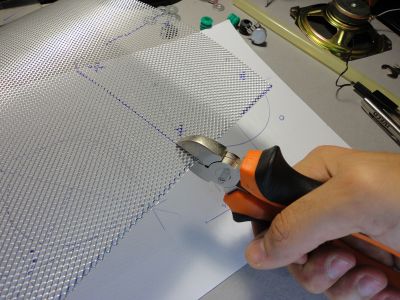

Cutting the Mesh
- Begin with the sides. Save the holes for later, when you have only smaller (and easier) pieces to handle
- Use the back half of the wire cutter's "blade" to cut easily
- As you cut, bend the mesh away from the tool
- Cut the holes with the wire cutters. If your wire cutters has a too big of a tip or the mesh is too tight, try hammering an X-acto blade through the screen
- Measure the screens against the cut keg and check if the holes align

Cutting the Mesh

The Transformer
The little transformer was salvaged from the same speaker set that provided the rectangular speaker, the mains cable and the amp circuit. Although it was the right size for driving the amp and two small speakers, when it came to driving four coils it began to heat up. Ok, no big deal, it just got a little warm, but i'm and overkiller. Check photo 3 for the upgrades.
Just so you know, such upgrades are totally optional. That's why i even didn't list the parts on step 2.

Step 9: Fitting, Part 1 - Transformer
Finally, time to actually build the keg, attaching all the stuff we've prepared up to now.
The order of fitting is crucial, as we'll have one hand inside the keg most of the time. Save the bigger pieces for later, so you have better access. For such reason, we'll begin with something small and that is installed in the very bottom of the keg, our power house, the transformer.
Check the photos!

Step 10: Fitting, Part 2 - Speakers and Screens
Grab the metal screen you cut in step 5 and bend them into shape.
For the simple (w/o holes for fixture) speaker we have to get creative. It was originaly held down by a spring steel bar that passed under its magnet and was fixed with two screws. This fixing feature was very stiff and applied lots of pressure to the frame it was screwd on. The keg isn't able to take such pressures without denting or bowing, so i came up with the following soft fixture:
- put the screw through the metal screen
- put a washer and nut onto the screw
- position the speaker in the middle of the four screws
- catch a strong rubber band under one of the washers, pull it over and around the speaker and beneath the washer diagonal to the first
- do the same to the other diagonal, cross-bracing the coil
- tighten the nuts enough to clamp the rubber bands, but careful not to cut them
The speakers with mounting holes were much more straight forward to put in place. Screen, screw, speaker, nut, rinse, repeat. It is that easy, so i won't talk much about that. The photos tell the story.
