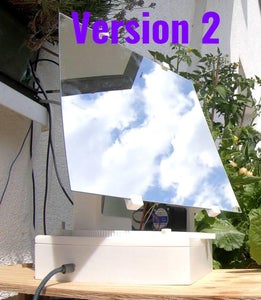

My first prototype was build of wood and uses servo motors to move the mirror. The servos are controlled by an Arduino and a realtime clock.
I was really happy with the result, but it was not very accurate and fails after a rainfall since the wood bends and the mechanic sometimes fails until it is dry again. There where other issues as well, so I decided to build a new one with parts from my new 3D printer.
This Instructable skips version 1 and shows how this new heliostat is build and what was done differently to hopefully work better.

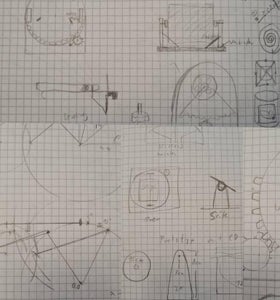

Step 2: 3D Printed Parts
All parts except of the electronics, the steppers, the screws and the mirrors are 3D printed.
I am quite new to 3D printing and designing this device was quite a challenge. To be sure that everything works, I have created some prototype parts. I wanted to test the following:
  • Do the parts fit together correctly? Especially since the size of the mirror is much bigger than the printing area of my 3D printer I have to make them connectable after printing.
  • Do the bearings fit together nicely? Do I need a ball-bearing?
  • How do the gears fit together? Does it work when moved via the stepper motors?
The result is working nicely, is light, does not use up too much filament and holds enough space for the electronics.
You can find the STL files in this Git Repository. The parts fit for a mirror with 30x30cm (a little less than 12x12 Inch). Since I have bought my mirrors from IKEA in Europe they are of course metric.
There are no specific print settings, I have increased the infill a bit to make it more sturdy, but it should also work with the default infill. You should use white or another color which does not heat up in the sun, since the heliostat need to stand in direct sunlight and dark parts could melt.

Step 4: Moving Parts
The mirror is placed on a holder which can tilt the mirror which is sitting on a big cogwheel to turn the mechanism.
Both axes, elevation to tilt the mirror and azimuth to rotate the mirror vertically are driven by stepper motors. Since I wanted to have a high accuracy and more robustness against wind, I printed a 10:1 gear from motor to mirror this increases the theoretical stepper motor limit from 1.8 degrees (200 steps per rotation) by 10 times. Theoretical because the stepper motor drivers have also micro steps to increase this accuracy up to 16 fold. This works only when you power the stepper motors continuously. Since I wanted to power the heliostat with solar power, I need to shut them down in between, otherwise too much power is consumed. This is no problem, but you cannot use micro steps since repowering the motor could lead to inaccuracies. So in fact it is a problem, since also the driver looses its position and you have to start again from a zero position which is not only loosing micro steps but also the coil polarities. So the accuracy is only 1/4 of one step of 1.8 degrees = 7.2 degrees. I have programmed the software accordingly and don't care too much since I still have less than one degree with the 10:1 gear.
Overall the mechanical accuracy of the 3D printed parts is not too high, but still high enough to not influence the result.
