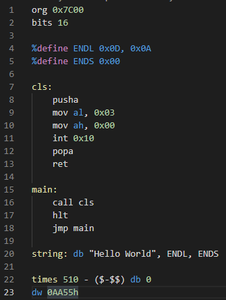

When we load the bootloader, we do not want to see the BIOS output. In order to get rid of it, we must clear the screen. To do this, we will type this above the main process:
cls:
	pusha
	mov al, 03h
	mov ah, 00h
	int 10h
	popa
	ret
This process, called "cls", will clear the screen when called. This is through the use of the system interrupt 0x10. More specifically, interrupt 0x10 AL=0x03. Interrupt 0x10 is the collection of interrupts used for graphics. Setting the AL register to 0x03 through the use of the "mov" instruction, the operation performed by the interrupt will end up clearing the screen. The use of the "pusha" instruction saves the value of all the registers, as they are overwritten in this process. At the end of the process, before returning with the "ret" instruction, we must call the "popa" instruction to restore the data saved with the "pusha" instruction.
Now, to clear the screen, we need to call the cls process from our main process. To do this: we simply need to add to the main process:
call cls
Now, when we execute the run.bat file and run the program through powershell, the screen will be cleared when the file boots.

Now, we must create a string. Underneath the main process, type:
string: db "Hello World!", ENDL, ENDS
Here, we have created a string. We have used the "db" or "define byte" process in order to set the string to "Hello World!" We then add a new line, with the ENDL command we defined, and then we end the string with ENDS.

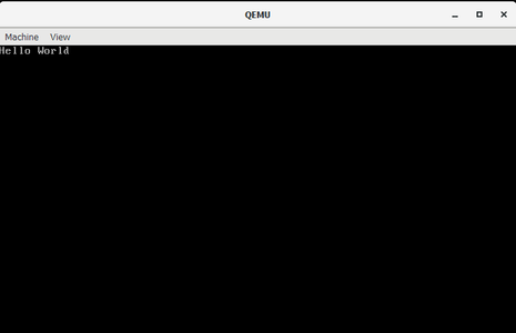

Now, we have almost reached the end. But, we aren't done yet. Now, we must move the string variable into the si register, and then call the printstr process. Inside the main process, type:
mov si, string
call printstr
However, if we were to run this now we may encounter some weird bugs, as the program will run the printstr process immediately. To prevent this, we need to add a new process above the printstr process that jumps straight to the main process. It would also now be a good idea to remove the hlt and jmp instruction from the main process, to prevent any looping.
start:
	jmp main
Now, we can compile and run the program.
