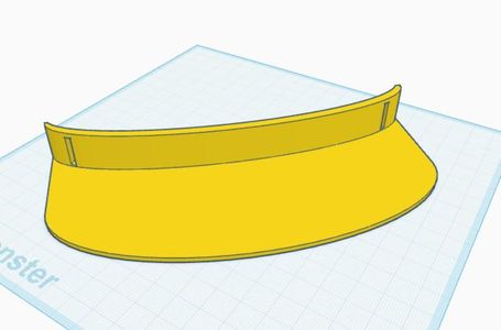

Step 1: Making the Design
I used Thinkercad to make the design for the cap.
I attached the .STL file to this step. That should make it easy for you to just print the cap. If your helmet has a different size or shape, my design might not work for you.
So I also shared the design on Thinkercad, here's the link to that: https://www.tinkercad.com/things/j1KHoWpMf0s-helmet-cap?sharecode=XPiAEj91hAvASQo4LFoJztCdci6R9PAQluS_BmVI2ps
Feel free to change it any way want.
