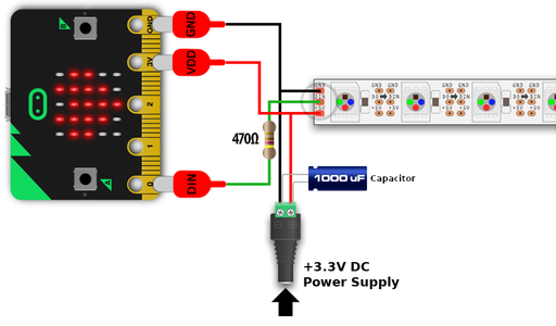

The circuit to connect a NeoPixel strip to micro:bit is elementary. One important thing is to power the LED strip externally, that is, not to take the power from the micro: bit. We take advantage of the fact that both the micro:bit and the NeoPixel strip are quite tolerant to supply and signaling voltages. Thus, we feed both from a battery holder with two 1.5V alkaline batteries following the circuit that can be seen in the above picture.

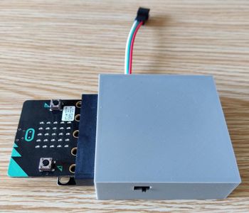

Step 2: Micro:bit Adapter

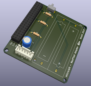

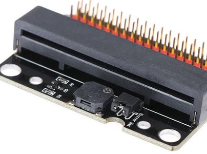

We started by making an adapter so that the circuit with the micro:bit, the LED strip and the battery would be solid. The starting point was one of the micro:bit to breadboard adapters available in the market. Since we were making the adapter, we thought we would support 3 LED strips instead of just one for future projects.
We designed a simple PCB with KiCad whose Gerber files can be downloaded from this link.
In one of the photos above, can be seen the connections in the JST connector. In this assembly we only use the pins GND, 3.3V and 0 as we only connect one LED strip.

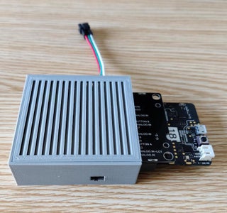

Finally, we made a case with TinkerCAD to be 3D printed.

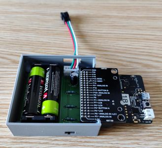

The final result with everything assembled (PCB, components, batteries, wiring for LED strip, case, adapter and micro:bit) can be seen in the last three photos of this step. The PCB is hot glued to case.

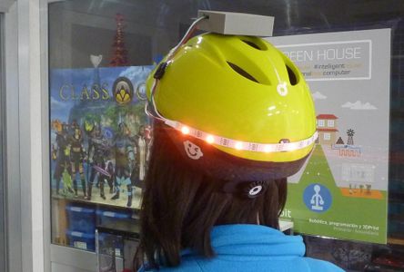

For the code we will take into account that a strip with ten LEDs was mounted. Five will go on the right half of the bike helmet and the other five on the left side.
The design conditions of the program are as follows:
- When the micro:bit accelerometer detects a deceleration, it will indicate that we are braking by lighting all the LEDs in red with a rapid flash for 3 seconds.
- When the gyroscopes detect tilting of the helmet to the right or left, the intention to change direction will be indicated by flashing the LEDs on the corresponding side for 10 seconds.

Step 4: Final Result
With a bit of double-sided tape both to hold the LED strip and the control unit, the installation can be done on a helmet. We can see that the above program behaves quite well:
